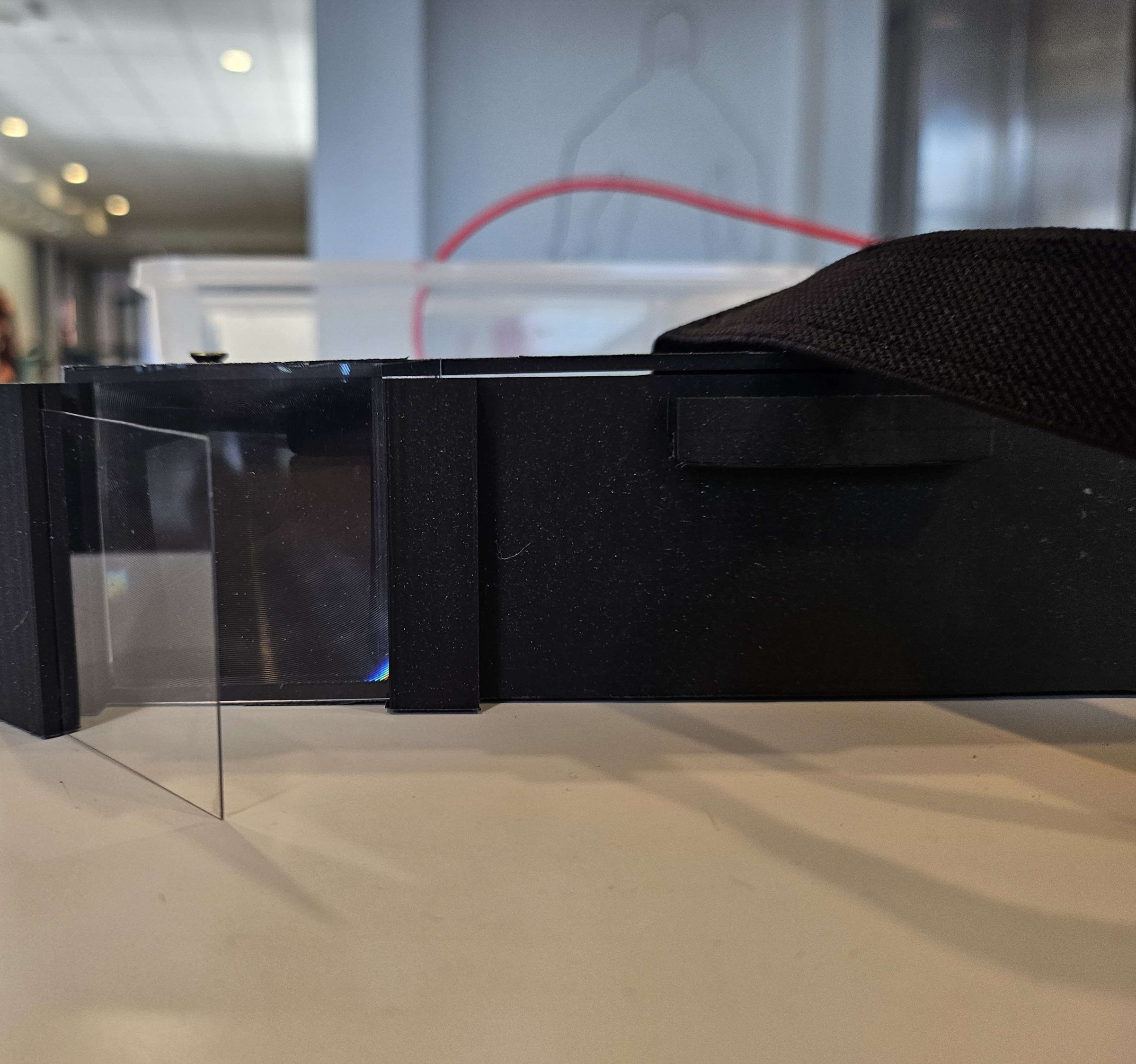

Step 3: The Case
For the encasing I used a laser cutter.
The first image has the phone holder and servo holder.
The second image shows the rest of the case assembled.
This part and the lid are both in the attached dxf file.
Add the servo horns to the servo's in the position as seen in image 4 when the servo's are in their 0 position.
I used 3mm thick mdf.
The box is 86mm x 106mm x 15mm.
The servo holders stick out 15.5mm are 35mm long and 3mm thick.
The inside of the box is 80mm x 100mm x 12 mm.
Step 4: The Lid
The first image shows the lid parts.
The second image shows the lid assembled.
The lid is essentially a small box with 2 holes for the servo horns.
The box is 122.1mm x 96.95mm x 9mm.
