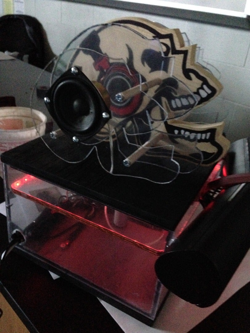

The Skull System was designed on a whim. I am a Technology teacher (Woodshop, Computers, Robotics, Metal Fab., etc.) so I am always looking for creative things to build, either with students or for my own satisfaction. The Skull System (3/8" Jack Surround Sound System) was born after I made the skull. I found the picture of the skull with headphones while looking for a new skateboard graphic (long board project I do with students). As so as I was finished with the skull I knew it was destined for more I just didn't know what. A couple days later it hit me. The skull has headphones on, why not make them functional speakers?! I obviously realized that the 3/4" pine I used would not be think enough for two speakers. I then came up with the idea to make it a 3D with plexi-glass of different thicknesses and sizes which not only gives the skull shape and depth but it allows you to see through and view the graphic I worked on. I didn't want a small box to hold the electronics so I kept them plexi-glass idea and built an over-sized box with plexi-glass sides to view all the electronics. After it was built and assembled I knew I could do more and make it even cooler. After playing music from and it noticing that sound is only projected from sides from the speaker orientation it dawned on me... Let's put a pair of variable speakers in the front too! Hell, I might as well line the inside with L.E.D.s to pulse to the bass!
The ending result is a hand drawn and painted skull with plexi-glass sides fitted with 3" speakers to make it 3D. It sits atop a plexi-glass box to house all the electronics and is lined with red L.E.D.s to pulse to the bass. A pair of speakers are mounted to the front for forward facing sound as well. Each pair of speakers has its own volume control to tune your music according to the space you are in. The Skull system is equipped with a 3/8" jack to plug in your audio source.

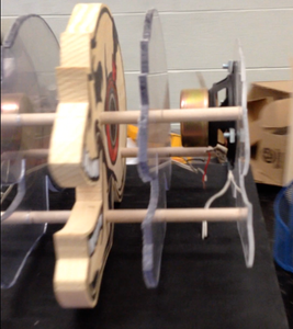

Step 4: Assembly of the 3D Skull
To assemble the 3D skull I used 3/8" wood dowels and a couple of wedge screws.
First install the speaker in one of the sides. From there you can see where you have room and the location of the hole for the dowel.
Mark the places with a sharpie and drill the width of the wedge screw you are using. Repeat this process for the amount of dowels you are using (In my case three).
Use the same technique as in step three. Overlay the cutouts and mark the new holes on the other cutout with a sharpie and drill.
We are again going to repeat this process except this time we will put the smaller cutout on top on the larger plexi cutout and drill with a 3/8" bit. Position the smaller cutout where you want it to go (I centered mine to feel like an actual skull where it gets smaller as you get away from the center). Mark the holes for the dowels and drill with your 3/8" bit. The wooden dowels will go through the wooden and large plexi skulls.
Lets repeat the process again except this time it will be the large plexi cut out on top of the wooden skull. Mark the holes and drill with your 3/8" bit.
Once all of your holes are drilled, take the small plexi cutouts and use a countersink bit for the holes where the wedge screws will be going. This is so the screws lay flush with the plexi.
**Important - When countersinking the holes be sure to countersink on the opposite side on the second small plexi cutout.
To assemble place the wooden dowels through each hole in the wooden skull. Then take the large plexi cutouts and slide them on both sides. Stand the partially assembled skull on its side and install one side of the small plexi skull. Screw the wedge screws in SLOWLY. DO NOT overtighten! The plexi will crack easily.
**Important - I drilled small pilot holes for the wedge screws to reduce cracking of the wooden dowels.
Marvel at your new 3D Skull! You can stop here and just keep your Brand New Beautiful 3D Skull or move on to make a bada$$ sound system.

Plug everything in, cross your fingers and hopefully start rockin' out!
Attached is a video of my finished 3D Skull Surround Sound System.
