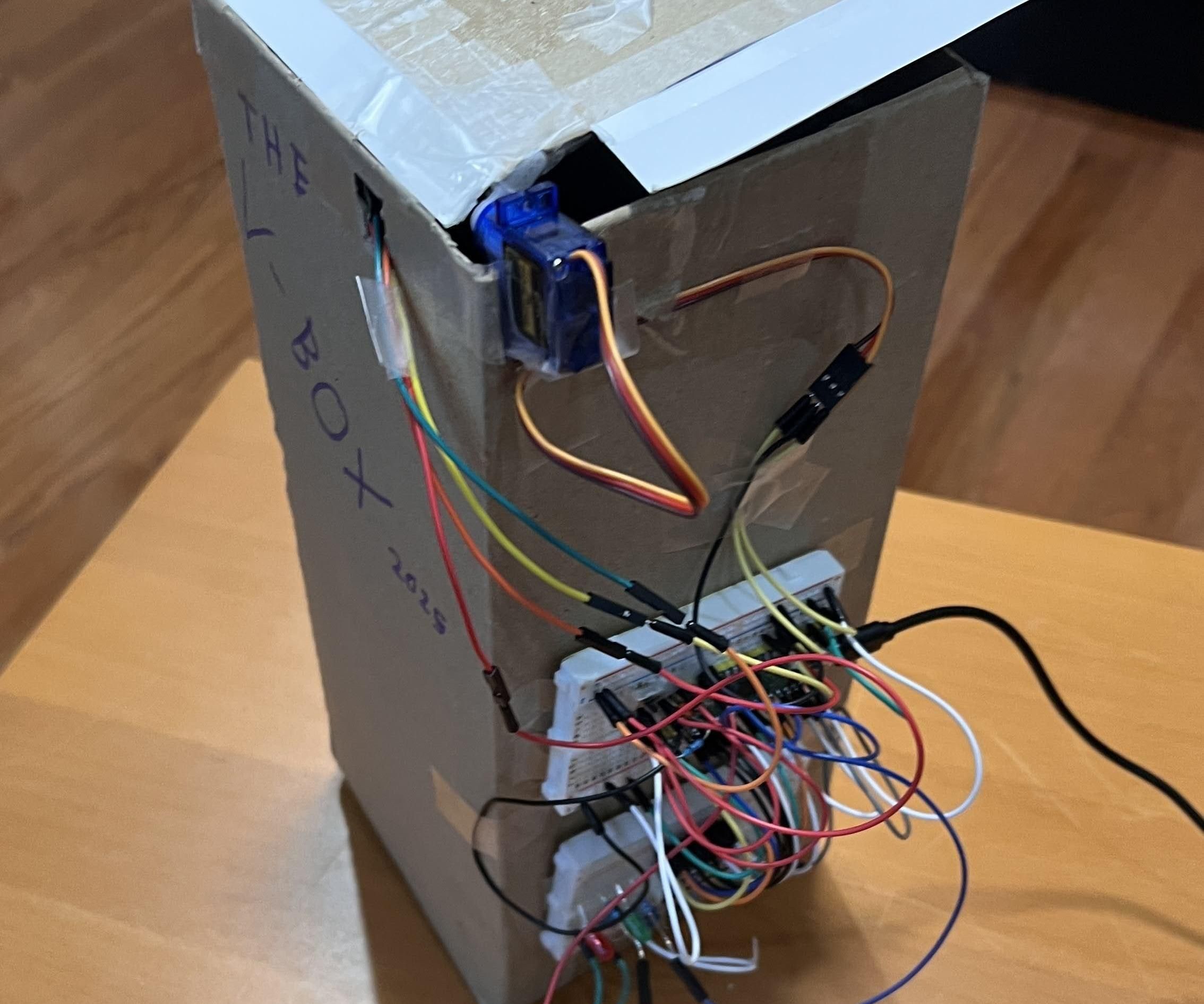

Step 1: Find a Box
You will want to find a box that is at least 5" in length, 2" in width, and 4" in height. Amazon boxes will do, as will HP instant ink boxes. If you want, you can also use a 3D printed box but make sure the holes in it are applied beforehand.
Step 2: The Circuit
If you are using different pins than provided in the schematic, please edit your code such that it will reach the right pins.
Step 3: Cutting Holes
To accommodate the circuits in your device, you will need to have some holes for the wires to pass through. This is because some of the components, like the dust sensor and the display, have to go through the box in order for the device to function properly.
The following steps will explain where to cut holes.
Step 4: The LCD
On the top of the box, cut a hole using a utility knife that the LCD screen can fit through.
Step 5: The Sensor
The sensor has 4 screws. Using a push pin, make 4 holes that you can put the screws through, and put the screws there. On the side, cut a hole for the wires to pass through, and fit the wires through it.
