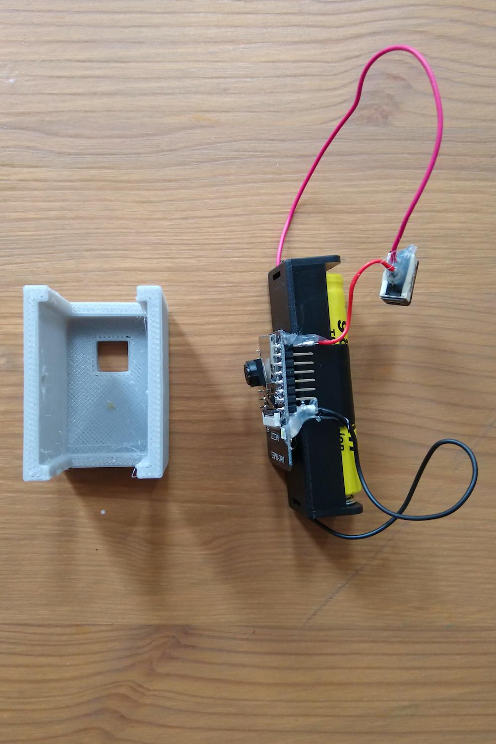

e) A case to put your electronics together and to hang it from the kite. I have 3D-printed a case, so if you use the same materials and have access to a 3D-printer you can print the provided .stl file.

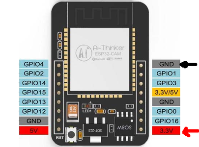

Solder one of the GND pins (e.g. the one with the black arrow in the pic) to the minus (-) pole of the battery.
Solder the 3.3V pin (red arrow in the pic) to one end of the switch and the other end of the switch to the plus (+) pole of the battery.
WARNING: Before soldering, make sure that everything works as expected. You can use dupont cables instead of soldering the pins, but the connections won't be stable enough for our use-case.

For the case, you can print the attached kitecam.stl file or you can devise something on your own. It is important that the whole assembly can hang from a central point in the kite - that is the purpose of the two holes in the case design. Moreover, by moving the battery case across the printed case, you can control how the whole assembly balances out when hanging from the kite.
Once printed, put the ESP32-CAM module with the camera facing down, so that the camera protrudes from the small square window and slide on top the 18650 battery case. The battery case should slide between the two pin-lines of the camera board and the whole assembly should be a really snug fit.

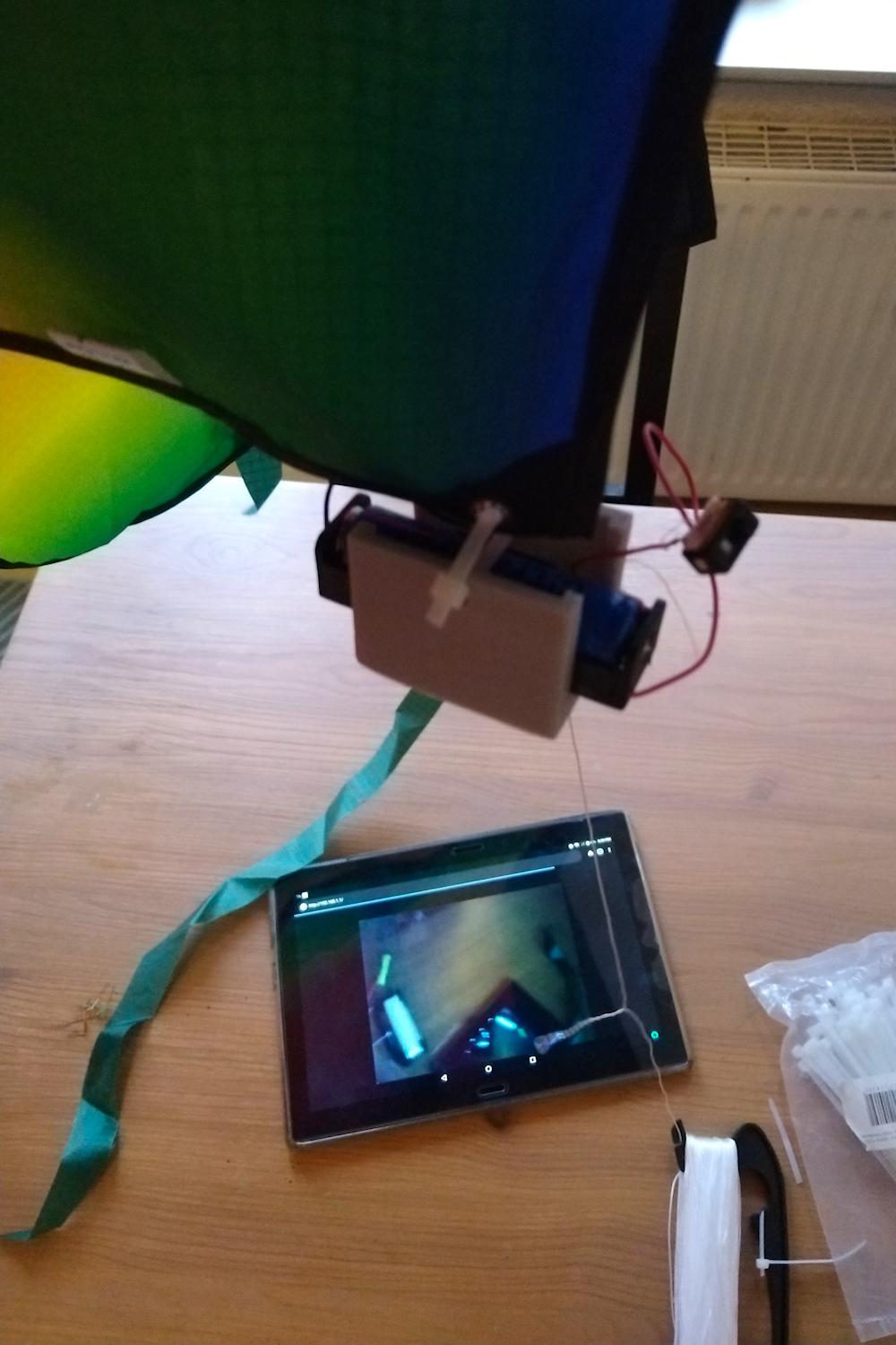

Step 4: Attach to the Kite
In the kite I used, the rope is very conveniently attached to a central hole on the kite. This is where I also used a cable tie to hang the camera assembly. Depending on your kite, you may have to improvise - make sure that the camera assembly hangs relatively loosely from the kite, so that it always looks more or less to the ground when flying.
That was it! Your kite is now equipped with eyes! Let it fly and enjoy the view!
