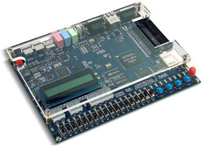

Introduction: The Altera FPGA and Quartus II Software
This is a step by step walk through of how to set-up and use Quartus software and upload it to the Altera Cyclone FPGA. Done as a primer for my school's(Ivy Tech CC) Digital Fundementals EECT122 course. This will cover in great detail the exact method to setup the software, your design and upload it to the FPGA(Field Programmable Gate Array) board.

Step 20: Download to Board
We have now created and function circuit with virtual gates and now we want to see it in real life.
- First thing is to assign to the pins on the Alterra board that we are going to use. For this example we need 8 input pins and one output indicator. The DOC attached to this step has the Alterra pin assignments.
