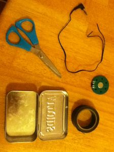

You will need...
* Felt
* An altoids tin
* An old pair of headphone or earbuds
* a mini speaker from a Hallmark singing card
Tools
* Hot Glue Gun (with glue)
* An awl
* A Hammer
* Soldering iron with solder (optional)
* Tin Snips
* Pliers
* Felt
* An altoids tin
Tools
* An awl
* A Hammer
* Tin Snips
* Pliers

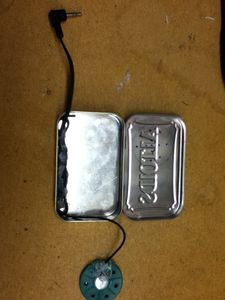

Cut the headphones off of the wire so you have two wires. Make sure the two wires are about 10" long. Strip the wires revealing a colored wire and a copper wire. The Colored wire is your positive wire and the copper wire is ground, or negative. The polarities will not affect the speaker, but it is a good thing to know which is which.
Step 3: Wire the Speaker

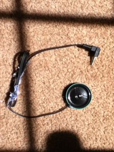

Clip the speaker out of the card so you still have the positive and negative leads. Twist together or solder one of the colored wires to the positive speaker lead, and the negative wire to the ground lead. You will only need one set of a colored and copper wires, so feel free to clip the other one back. Wrap the connection with electric tape, and plug the speaker into your ipod to test it out. If it doesn't work, check your polarities. If it still doesn't work, check to make sure your connections are good.
Step 4: Preparing the Tin

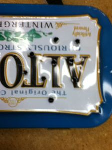

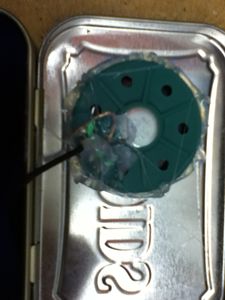

If you have a lot of cord (1'- 11/2 '), you may want to wrap it up and glue it together so it can fit inside of your tin. Look at the picture for reference. Trace the hallmark speaker on the top inside part of the tin, and draw 7-12 dots inside of the circle you drew. These dots mark where you will be making holes for the sound to come out.
Step 5: Assembling the Wire

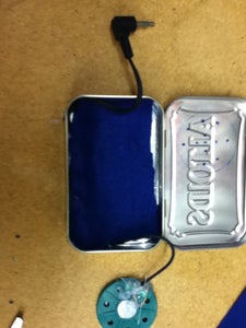

Hot glue the bundle of wire onto the side of the altoids tin as shown in the picture. Cut out a piece of felt the size of the tin, and hot glue it onto the bottom of the tin. This is to protect your ipod when you put it in here, and it also makes it look nice. Before moving on, check to make sure that your ipod fits in the tin. If not, you may want to change the location of the bundle of wire.

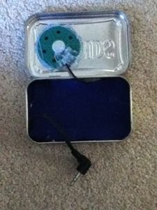

Step 6: Assembling the Speaker
Put an extra layer of felt so the wires below are hard to see. This is optional, but it does help to protect your ipod, and it makes the inside of the tin look cooler. Using the awl and hammer, make a hole on every spot you marked on the top of the tin. Hot glue the speaker over the holes as shown in the picture. Make sure the speaker is really in place because you don't want it to be coming apart while inside the tin. Also, don't get any hot glue onto the diaphragm of the speaker.

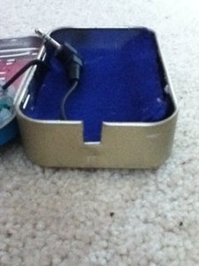

Using the tin snips, cut two slits on the side of the tin, and bend it back using the pliers. Look at the photo for reference. This is so if you have an ipod or other device that is too large to fit inside the tin, you can simply pull the wire out of the tin and then plug in your device. You may have to make your slit bigger depending on the width of the wire.
