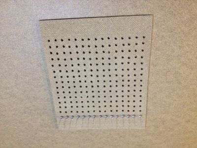

Step 4: Drill Holes Into the MDF Board
First, mark the placements of the holes using a pencil or similar. The easiest way is to draw lines horizontally and vertically, spaced 1/2" apart in the 8"x8" segment you want the LEDs in. Try to make sure that your lines are as perpendicular as possible, and that they are evenly spaced. Otherwise, your LEDs won't line up with your maze.
Where the lines intersect, you may want to make small indents using a hammer and nail to guide the drill bit.
Drill 3/16" holes (assuming 5mm LEDs) through the MDF board in the marked intersections.

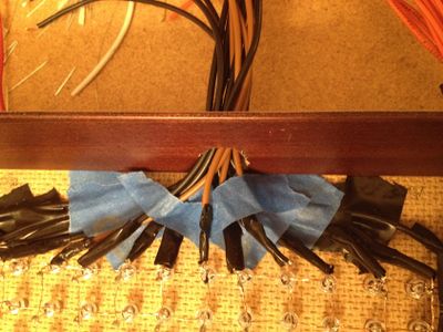

Step 11: Solder Insulated Wire to Every Column Lead
Solder each individual column wire to a separate and respective insulated wire. Carefully wrap every dried solder connection with electrical tape to protect the connections.
The length of the wire will depend on how far away that particular column wire is from its picture frame hole. If you are not using a picture frame, just leave yourself enough insulated wire to comfortably reach the Nexus 3 board from that particular column.
Make sure not to let any bare wires short against each other!

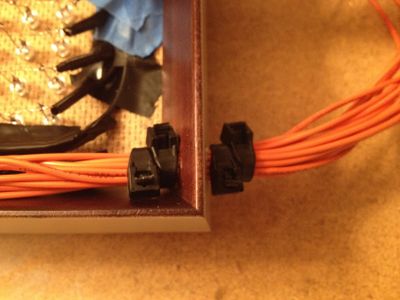

Step 14: Pass Insulated Wires Through Holes (Optional)
Pass all the insulated column wires through one hole and pass all the insulated row wires through the other hole. You may have to make your holes slightly larger if your wires don't fit through.
Be gentle with these wires, as the thin connections are liable to snap if mistreated.
Once you have all the wires passed successfully through the holes, zip tie each bundle of wires on each side of the hole to keep them snugly in place.

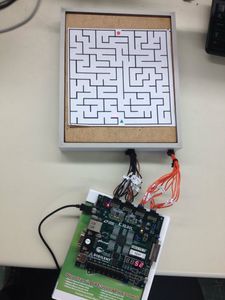

Step 15: Wire the Grid Up to the FPGA
Connect all of the wires of the grid structure to pins on the 100 mil header. Our suggestion is to set up row/column 0-7 and 8-14 as a header each for both directions, running the top line and then the bottom line in order.
Insert the headers into the Nexys 3 Pmod ports, making sure to align them with the data pins, rather than ground and power.
Due to the number of possible orientations for the board leads, it is highly unlikely that our pin assignments will work for anyone else. We therefore recommend doing this part yourselves using Xilinx or PlanAhead to edit the pin assignments. You can refer to the Nexys 3 Reference Manual, page 21, for the pin designations.

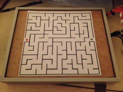

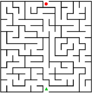

Step 16: Print Out and Trim Maze Overlays
Print out the attached maze overlays (with start and finish markers), making sure to print to scale, not full size.
Trim them down so the margin on each edge is no more than a quarter inch. This will allow them to fit inside a frame.
Optionally, you can make a mark across the overlay and the MDF board with a pen or marker in order to show the correct alignment, once you have found it.
Note: We took the design for our hard maze from the website Maze Generator. This site is a fantastic resource for quick and easy maze creation, and they allow you to make mazes of any dimension you want. As far as we can tell, there are endless maze possibilities from this site as you can just keep generating new mazes to your heart's content. While we do encourage players to create their own unique mazes, this is a great jumping off point and source for inspiration.

Step 18: Enjoy!
The game will begin immediately after programming the board. The game instructions are listed below.

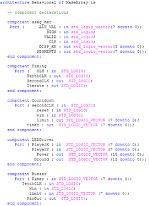

Step 21: Component Overview
MazeArray is the top block. It mainly transfers data between the other components, but also has direct control over the processes that choose the correct maze, hold the mazes' data, and navigate the player around the maze.

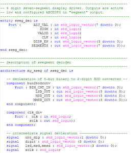

sseg_dec decodes an 8 digit binary signal into a number and drives the Seven Segment Display. This VHDL is courtesy of Bryan Mealy, a professor at Cal Poly.
Timing consists of a series of clock dividers for use in other components.

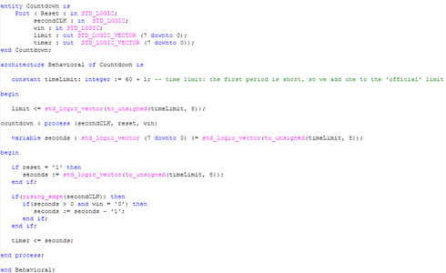

Countdown defines a time limit on the maze, and decrements a counter that feeds into sseg_dec once a second.
LEDDriver assigns output pins high or low depending on the space currently occupied by the player so that the correct LED will light.

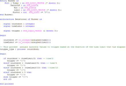

Buzzer theoretically provides functionality for a beeping noise to accompany the countdown, increasing in frequency as the timer nears the end. This feature was unfortunately not tested or implemented at the time of writing, but should work using a DC piezoelectric buzzer.
MazeArray.ucf is the constraints file containing the pin assignments. This is where you can edit them to suit your specific configuration.

- Mealey, B. (2014) (Version 1.0) [VHDL]. Special seven segment display driver. (Accessed on 4 December 2014).

Step 26: Sseg_dec - the Seven Segment Decoder
This module was created by Bryan Mealy, a professor at Cal Poly San Luis Obispo. It takes in an 8 digit binary standard logic vector, and outputs suitable signals to drive the seven segment display on the Nexys 3 board.
It was given to us a black box, and so shall we give it to you. It’s well-commented, though, so if you're curious, it shouldn't be too hard to figure out.
Step 27: Timing
Timing starts with I/O and variable declarations. It takes in CLK as an input, and outputs the divided clocks TenthCLK, SecondCLK, and Iterate.
On the rising edge of clock, slow_count increments. When clock has cycled 5 million times, slow_count resets, slowCLK oscillates, and tenth increments. 5 million is chosen because a 100MHz clock will clock that many times in a half of a tenth of a second. This means that slowCLK and tenthCLK have a period of one tenth of a second. Similarly, secondCLK oscillates every half second when tenth equals ten, meaning secondCLK has a period of one second.
Additionally, Iterate oscillates on all even values of tenth, corresponding to each tenth of a second, giving it a period one fifth of a second long.
Step 28: Countdown
Countdown takes in reset, win, and secondCLK as inputs, and outputs limit and timer, which transmit the maximum and current values of the countdown timer, respectively.
Countdown declares a timeLimit constant. The initialized value is 1 greater than the ideal time limit for the maze. This limit is then output as a standard logic vector.
The countdown process has two functions. If reset is on, it resets the seconds countdown to the initial value. If not, it decrements seconds on the rising edge of the secondCLK if win is not on. This means that the display will keep the time taken to complete the maze on it until reset.

Step 30: Buzzer
Buzzer takes in timer, tenthCLK, win and limit, and outputs PinOut. Countdown is the integral equivalent of timer, and timeLimit is the integral equivalent of limit. Trigger is a two bit logic vector that conveys information on the value of the ratio of countdown to timeLimit.
The trigger_type process compares countdown to fractions of timeLimit to determine how frequently to actuate the buzzer using an ‘if’ tree.
The beep process first declares a bunch of variables which count twentieths of seconds for different cases. On the rising edge of tenthCLK, beep will either perform a series of victory beeps if win is on, hold a tone if countdown is 0, signifying a loss, or otherwise perform normal operation. This consists of a case statement based on trigger which increments the relevant count and beeps when the count resets at its specified value.
The resultant behavior is that when countdown is greater than half, there are no beeps. When countdown is otherwise greater than a quarter, beeps occur every two seconds. Between a quarter and a tenth the beeps occur every second, and finally, at less than a tenth remaining, there will be beeps every half second.
Step 31: Reprogram the Nexys 3 for More Mazes
You can also create your own mazes!
One resource to consider is the Maze Generator website that we got our hard maze from.
Once you have a maze design, you'll need to convert it to the array format we used. In this format, walls surround every player space, leading to a (2n+1) x (2n+1) array for an n x n maze.
The best way to envision this is that the grid of lines on the maze are really thin boxes that have equal width in the maze. The corners also have their own spaces, even though they are never used.
See Step 24 for more info.
The attached Excel file contains the blueprints for our implemented mazes, as well as a template for your own!
