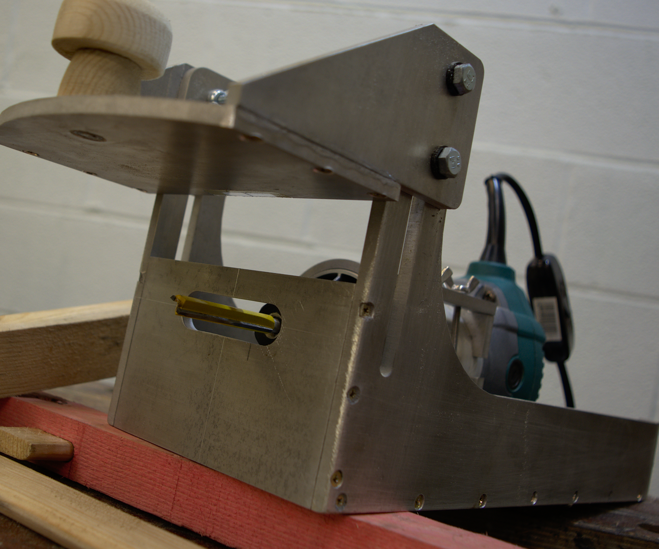

Retro jigsaw
Scroll saw
Sander
Router and table

I drew around the leg and cut out the shapes leaving a few millimeters border. I did this so I could trim off the excess using the router.
I wanted all of the legs to be exactly the same. I used double sided tape to stick the original leg to the ones in need of trimming
