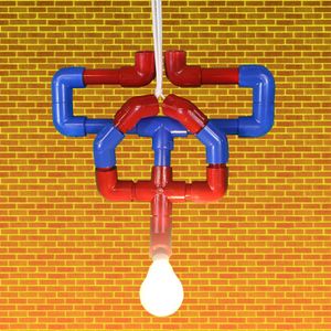

Step 2: Starting the Body
Starting the Body
First start with a PVC cross and connect a 2 inch long pipe.
Then add a Tee connector to the 2 inch pipe.
This created the torso.
Then starting on the arms, add a 1.5 inch long pipe to each side of the cross.
Next connect a 90 degree Elbow to each pipe.
Again add a 1.5 inch long pipe to each side.
Next connect a 45 degree elbow.
On those elbows add a 1.25 inch long pipe.
Then add one more 45 degree elbow to each pipe.
The arms are complete.
Step 3: Adding the Legs
Adding the Legs
In the Tee connector, insert a 4 inch long pipe to each side.
Then add a 90 degree elbow to each side.
Attach a 1.25 inch long pipe to each elbow.
Add an additional 90 degree elbow to each pipe.
Connect a 3 inch pipe to those elbows.
And finally add the last two 90 degree elbows to those pipes.
This completes the body.

It is now time to paint the lamp.
Carefully remove the leg sections and paint separately.
Try to avoid getting paint inside of the connectors or it can be hard to assemble.
For the upper half of the body, start by painting the elbows blue and wait to dry.
Then add painter’s tape and finish with red.
After the paint has dried, remove the tape.
Assemble the body together.
