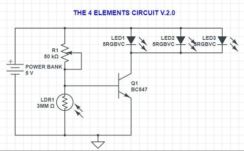

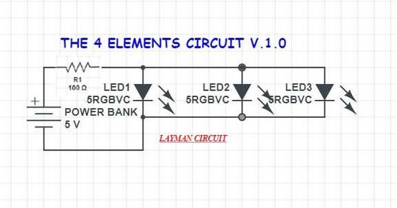

I am an electronics guy so how can I leave a project without it. So I have made a special light blinking circuit that turns on automatically at night and turns off in the day in the light. All the components are available in any electronics shop nearby you or else you could find them online. I have rather made 2 versions of the circuit. circuit version 1.0 is for the electronics layman. And version 2.0 is also for laymen who can do little more effort to make the circuit on-off automatic. Definitely, for an electronics guy, this is just a cakewalk. See, components in the image and list below.

We have two circuit diagrams version 1.0 and 2.0. Both work fine. The only difference is version 2.0 turns on and off automatically. At night turns on automatically and turns off in the day. You can choose whichever you like.

Sensitivity Adjuster: LDR, a light-dependent resistor, as the name suggests its resistance decreases as the light intensity increases. So, we have to adjust the sensitivity by rotating the know such that LED lights stay turn off when there is light in the room and turn on when there is darkness in the room. You can change the sensitivity at any time like when you have shifted the Ambiance Organic Lamp to another room where light and darkness are in different proportions as compared to the previous.
