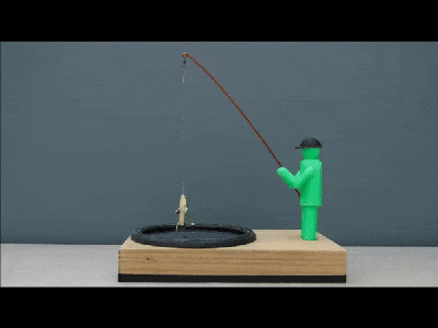

Introduction: The Angler
Having previously made a project called "The Flitter", I decided to make another project that utilised the same methodology but presented in a different model.
The model in this case is the "The Angler" with a fish on the end of the line over the water, utilising wood, acrylic, brass and 3d printed elements with simple electronically controlled magnetics.
The fish containing a permanent magnet is animated whilst the angler is static holding the rod to which the line and fish are attached. Beneath the pond is housed the electromagnet and hall sensor with the electronics that in conjunction with the magnet in the fish influences movement due to the interaction of a pulsed magnetic field.
Due to the use of the same methodolgy some steps will be identical between the two projects but for continuity and completeness each can be viewed independently.
Final dimensions: 95(W) x 165(H) x 150(L) mm

Step 1: Pendulum
A simple pendulum is a tether fixed at one end to a point that pivots in one plane and a weight that can be fixed or moveable to adjust the swing period.
This project uses an elastic pendulum which differs from the simple pendulum in the following manner.
1: The pivot point is not fixed in one plane but is free to spin and swing in both the X and Y planes with some small vertical movement in the Z plane.
This is accomplished by attaching the pivot point to a semi rigid wire which will flex (effectively a spring), causing the pendulum to bounce and a rolling barrel swivel to enable spin, all which impacts the swing.
2: A rigid tether is replaced with a flexible thin wire.
This allows the tension [influenced by 1], in the wire to vary which effects the radius of the swing arc.
3: The weight is fixed at the end of this elastic pendulum and in conjunction with 1 & 2 also impacts the swing.
All these continual variations create a chaotic swing which like the typical pendulum would stop if an impulse was not applied to keep it moving.
In this case the impulse is a magnetic pulse which in conjunction with a permanent magnet (fixed at the end of the elastic pendulum), interacts with the magnetic pulse (either attracted a repelled depending in the polarities of the magnetic forces at play).
This impulse is applied when the permanent magnet passes a Hall sensor resulting in the pendulum being pushed or pulled continuing the swing.

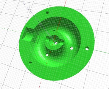

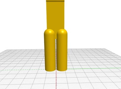

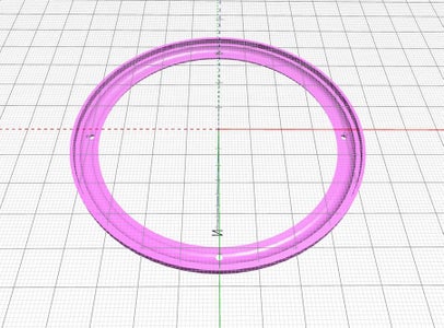

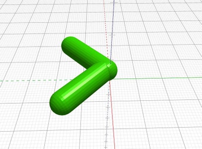

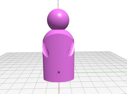

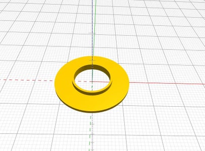

Step 2: CAD Design
The 3D printed elements were designed using BlocksCAD, sliced using Cura 4.5.0 and printed on a Labists ET4.
The elements of the Angler are scaled at 75% of full size creating a figure ~77mm high.
Torso
Legs
Arms x 2
Hat
The following are printed at 100%
Pond Edge: 92(dia) x 6(H) mm
Coil Holder: 41(dia) x 11(H) mm
Coil Former x 2: 26(dia) x 2.5 mm

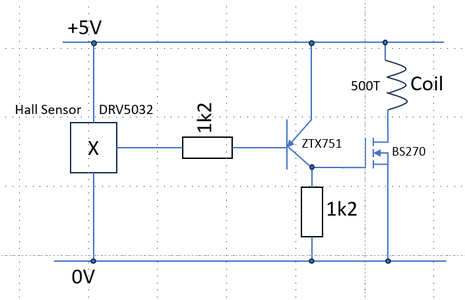

Step 7: Circuit
Motion of the Fish is created by the interaction of the magnetic attached to the body and a pulsed magnetic field generated in the coil when the magnet passes the Hall sensor.
The Hall sensor (will detect a magnetic field of either polarity), in the presence of a magnetic field it will have a low output and a high output in the absence of a magnetic field.
The output is connected to the base of a PNP transistor which is switched off when the sensor output is high and switched on when the sensor output is low.
The PNP transistor is used as an inverter between the sensor and the NFET.
As its required to energise the coil when the sensor detects a suitable magnetic field the gate of the NFET requires a positive voltage. However, in the presence of a magnetic field the sensor output is low. Thus the requirement for the inverter.
The coil is mounted close to the sensor such that when the magnet passes the sensor the coil is switched on.
Assuming the magnet is orientated to be attracted to the coil.
This immediately attracts the magnet towards the coil but in doing so it moves away from the sensor. The deminishing magnetic field to the sensor results in the coil being switched off. The magnet then swings back towards the sensor re-energising the coil and repeating the process.

Solder the wires to the appropriate points on the circuit and run the wires in the depression in the wood using the masking tape to hold the wires in place
Solder the supply wires to the USB-C breakout and solder to the appropriate points on the circuit and run the wires in depression in the wood using the masking tape to hold the wires in place.
Test the operation with the fish or magnet on a wire to verify both the coil and sensore are working.
When the coil is acttive you should feel a pull or push on the magnet.
If the sensor is functioning the magnet should noticably swing.
If there are any issues double check the wiring.
Fix the legs of the angler in place with 2 x M3 x 25mm screws.

Step 13: The Pond
The pond consists of a suitable coloured disc to represent the water, covered with a protective clear acrylic disc held in place with an edge ring.
Choosing a suitable coloured paper and using the acrylic disc as a template cut around the disc and into the paper with a sharp craft blade.
Tape the acrylic disc and the paper disc to the edge ring.
Using the holes in the edge ring as a guide use a 2mm drill bit to make 4 holes through the acrylic disc and through to the paper.
Fit the complete sandwich to the front of the wooden base using the screw holes previously marked with 4 x M2 x 8mm screws.

Step 15: Final Assembly
With the base orientated pond uppermost place the torso over the legs.
Place the rod end without the loop in the hole in the torso and rest the remainder of the rod on the gap between the hands such that the fish hangs over the pond.
Apply the power via the USB lead to activate.
