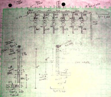

Step 1: Design the Manifold

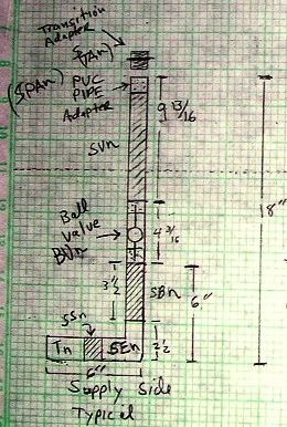

The first thing I had to do was design the manifold. You can buy ready-made manifolds, but I wanted control over this, so I decided to design mine from the ground-up. I designed the manifold input to come into one end, and to leave the other end capped off in case we wanted to expand the system.
I know that my handwriting is hard to read, and the fact that we’re trying to read from a photograph is even more difficult, but please bear with me.
I tried to label everything in a standard manner so that my “Old-Timer’s wouldn’t get the best of me. Also, all of my connectors are slip connectors except where noted. I’m using one inch Schedule 40 pipe (which must be cut on a saw, not with hand pipe cutters.)
The first idea is to bring the valves as close to a wall as possible but still allow room to work on the valves. That led me to design a straight line manifold run with slip Ts at 90° perpendicular to the main manifold run. Here I’ve labeled the pipe MSn where MS stands for Manifold Side, and n is one of the integers 1-7. I have also labeled the slip Ts T 1-6, which corresponds with one of each of the valves. On the input side of the manifold is elbow EM, for Elbow Manifold, and on the opposite side I have a slip to female threaded connector labeled SFT, I suppose for Slip Female Thread.

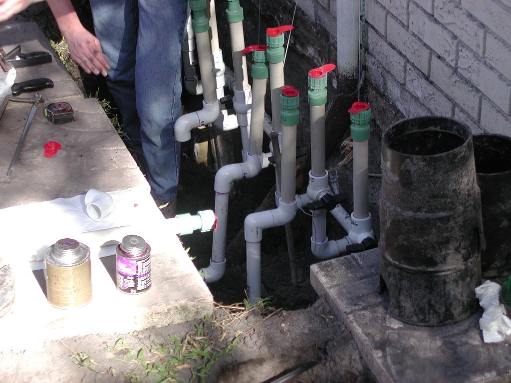

Step 3: Start Cutting PVC Pipe
Most of the cuts will be on the circular saw with a PVC blade. Makes cutting one inch schedule 40 pipe a breeze.
Step 4: Start Welding PVC Pipe
As you can see, I marked every piece with its part number.

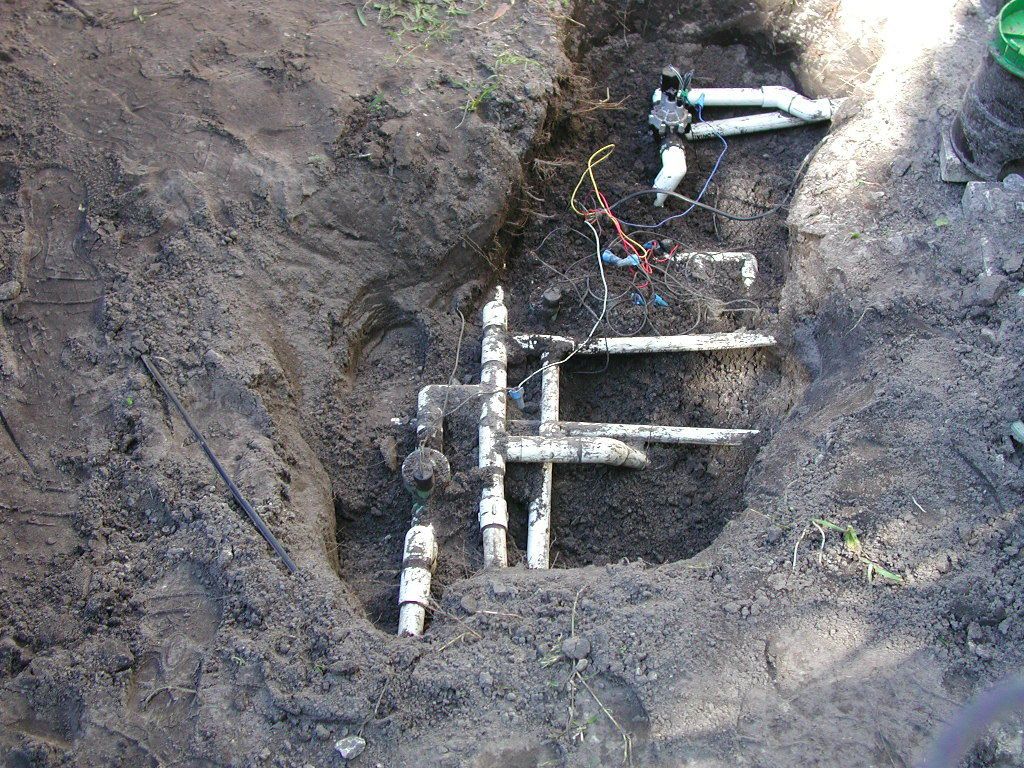

Step 5: Dig Out the Old Valves
Luckily, this was in November, so it was relatively cool to start digging.
Step 6: Start Installing
Now it's time to cut out the old valves, and route the laterals to the new valve area. I stuffed shop towels into the cut-off ends to try to keep dirt out of the pipes.
We also stuffed shop towels into the new pieces for the same reason.
Step 7: More Installation
There certainly lots of joints to weld, and the whole is quite too small for me. I'm very lucky that my wife is very small and nimble!
