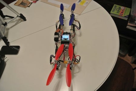

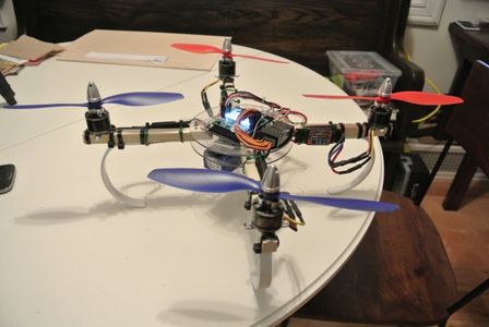

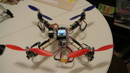

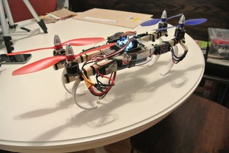

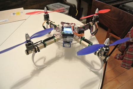

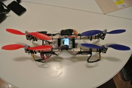

This is a how to build video of a small folding quadcopter, based on the "Anycopter" hub. I go through the different steps and also a quick overview on how to setup the KK2 flight controller and a maiden flight.
I really like folding multicopters, makes it easier to store and transport in a bag. The quadcopter, uses short wooden booms, Lexan body, Hobby King 20A ESC flashed with simonk and some 1200kv motors, 8" props and makes for some really fun and exciting flying.
