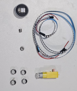

Hardware and Electronics
Neopixel (144 Led's per meter)(120 Led's to be used)
Bearing 12x16mm (Roller)(4)
Bearing 8x5mm (Ball)(1)
BO Motor (single-shaft)(1)
Seeed Studio SAMD21 (Micro-Controller)(1)
Wires (5)
3x6mm screws (2)
2x12mm screws (2)
6x8mm magnet (1)

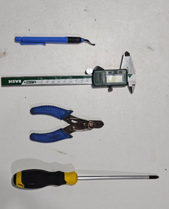

Tools
Screwdriver (1)
Gel based super-glue (1 Bottle)
Soldering Iron (1)
Solder (1 Spool)

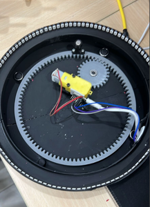

Gear & Base Assembly

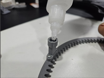

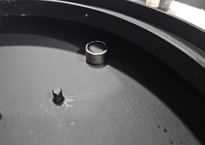

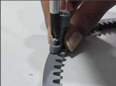

  1. Screw the spur gear and magnet connector together.
  2. Apply glue inside the connector cavity and insert the 6×8 mm magnet.

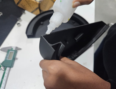

  3. Glue both base plates together to form the main clock body.

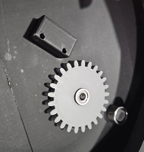

  4. Insert the roller bearings onto the four corner cylinders.
  5. Place the ball bearing on the smaller cylinder.

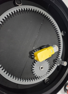

  6. Add the middle gear on top of the ball bearing.
  7. Install the small motor gear onto the motor shaft
  8. Attach the BO motor to its mount using 2×12 mm screws
  9. Place the ring gear inside the roller bearings and ensure it meshes with the middle gear.

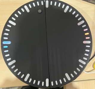

Finishing Touches
  1. Apply small dabs of glue and insert the translucent hour and minute markers into the holes.
  2. Attach the top cover using tape or non-permanent fasteners for easy maintenance.

Step 5: Functionality
The two videos above show the functionality of the LED lights, one displaying the Hour and the other displaying the minutes, in this case, it would be the red one showing hours and green showing minutes.
(The LED's are a bit less visible in the video but I can assure you they are clear in real life)
The video attached above also shows moving objects such as a resin printed design, a benchy and even a pawn chess piece. These all are containing of magnetic components therefore acting as the second hand of the clock. Similarly anything with a decently strong magnet or with one attached to it can repeat the same motion.
