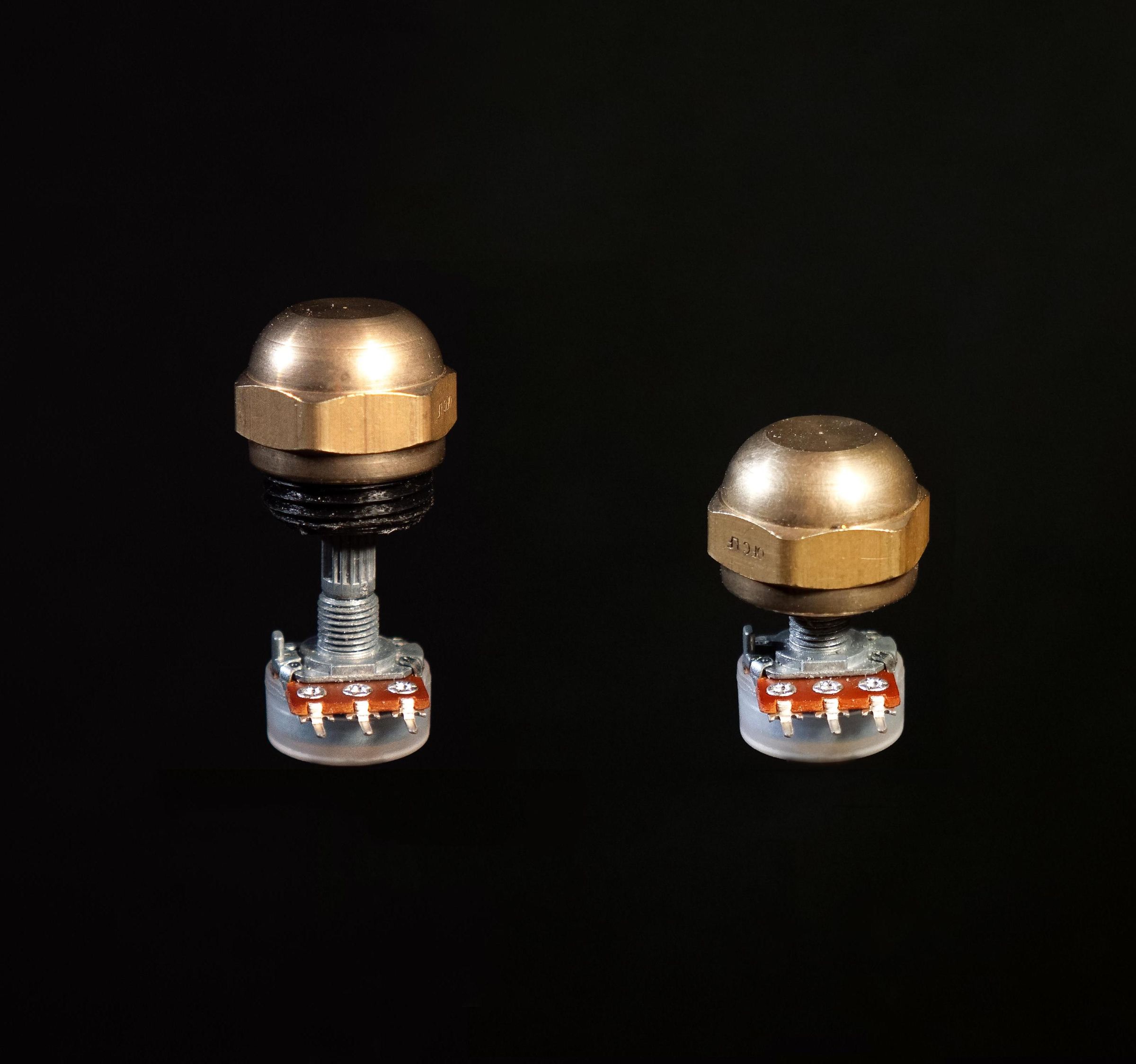

Because my local hardware store was out of female threaded knobs in the size I'd wanted, I made my own. I purchased knobs meant for a standard 1/4"-20 bolt head and glued a nut inside with 5-minute epoxy. In this orientation, I have no worries that the nut will become loose with use since tightening the knob pulls the nut into the plastic handle.
