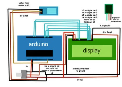

Chicken eggs need a temperature between 23C and 25c (99F to 101F) and humidity of 90% to properly incubate. I used an arduino to control the incubator's self regulation. A DHT22 sensor detects temperature/humidity and sends it to the arduino to display it on the LCD.
Step 5: The Fan and the Relay
The fan is ripped from an old power supply and used to blow out hot air. It's connected to a 12v source switched by a relay on D7 on the arduino.

A list of the part I've used
Arduino UNO
Breadboard or any circuit rail
DHT22 Sensor
A fan( preferably a PC fan, If you want to use a heavy duty fan, you can do so. I just don't know the best way to split 120v 2 amps through the relay)
I've included the schematics
