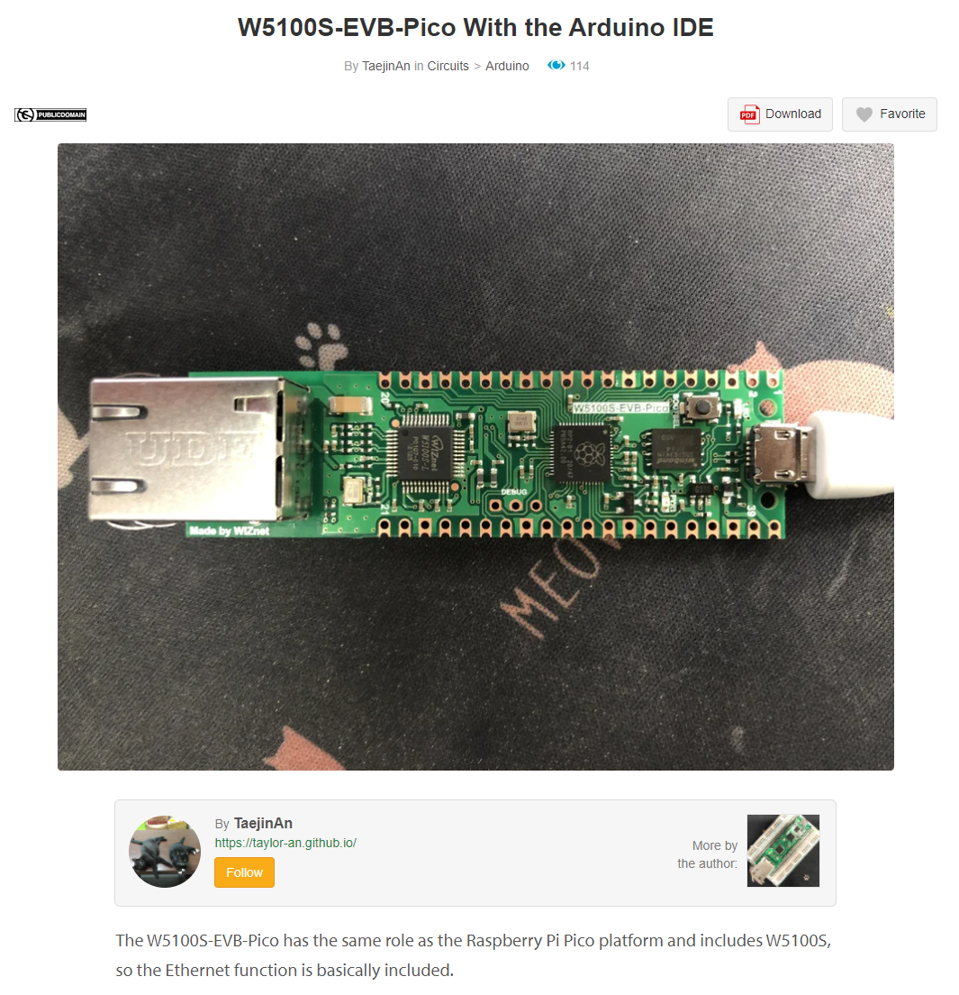

Introduction: The Arduino Raspberry Pi Pico/RP2040-Ethernet V2.1.1
After I had released 'WIZnet-ArduinoEthernet/arduino-pico' version 1.0.1, W5500-EVB-Pico, and WizFi360-EVB-Pico were launched.
So, there are three WIZnet RP2040 boards which pin compatible with Raspberry Pi Pico.
Step 1: WIZnet-ArduinoEthernet/arduino-pico
Thankfully, arduino-pico (Mr. Philhower) supports it already.
Both the W5100S-EVB-Pico and the W5500-EVB-Pico used the same RP2040 SPI pins. Therefore, there is no issue using with Ethernet Library.
On the other hand, the WizFi360-EVB-Pico uses WizFi360_arduino_library. Moreover, it uses AT-Commands through UART.
It was not hard to decide to support it, but it was hard to catch up with the steps of arduino-pico.
Now the arduino-pico(WIZnet modified) library supports these three boards on version 2.1.1.
