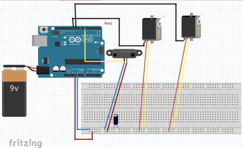

Step 3: Circuit Schematic:

The proximity sensor detects the motion triggering the servos movement. The 3D printed arms, with holes on each end (one for holding the string and one for the attachment to the servo head) are lowered, dipping the string into the glyceri/bubble liquid and bringing them back up to air flow of the 12v computer fan. The fan has been programmed to blow at random from 2-5 seconds each time, using the delay(random(2000, 5000)) function as seen in the code allowing for varying sized bubbles and formations.
