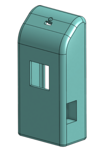

The full 3D CAD model of the final design can be downloaded from Onshape as SOLIDWORKS or STEP files, and the stl files themselves are available on GitHub. B.U.R.N. Meter's enclosure is dustproof, and it uses a 1/8" acrylic sheet to protect the flimsy LCD screen from direct contact, and it also features a small piece of fused quartz glass plate to cover up the UV sensor. This creates a physical barrier between the sensor and the environment, which prevents small dust particles and sand from entering and potentially shorting out something in the device. This particular fused quartz plate also has a very high UV light transmission (nearly 90%), which means the sensor can still work well behind it. I used self-threading M2 screws as the fastener of choice to secure the electronics to the box since they don't require us to have a particularly good 3D printer capable of printing threaded holes. These screws cut their own threads and are designed for plastic, which fits our application well.
The top of B.U.R.N. meter is sloped at about 42 degrees, meaning the user can look at the screen from a comfortable angle with the opening to the sensor pointing straight up, preventing the edges of the hole from shading the sensor and skewing the UV index reading. I played around with different sloping angles, and this ended up being the most comfortable to me, but depending on your particular physique, a different angle may be better for viewing.

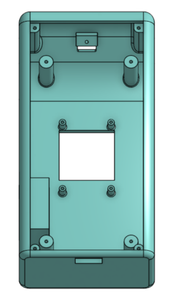

A large rocker switch makes it easy for users to turn the device on and off, and the recessed port for the rocker switch makes it sit a couple centimeters inside the perimeter of the box, lowering the chances of it being accidentally toggled if someone puts it inside a backpack with many other objects.
Finally, since there need to be an opening on the B.U.R.N. meter to allow the user to plug in a micro USB cord to the battery charger, I made a simple snap fit plug for the port with a hole in it so that it can be attached to the back of the box via a thin string or wire. I've lost a number of these plugs I printed inadvertently since they are so small, so physically tying it to the rest of the device was a game changer. The micro USB port is pretty far inside the device, so the entire head of the charging cord needs to be able to fit through that hole. If your charging cord's head is taller than mine, you will want to either adjust the CAD model when you print or simply scrape off excess material with a small blade to enlarge that hole. The plug should still stay in there since the snapping mechanism engages the sides of the hole, not the top or bottom.

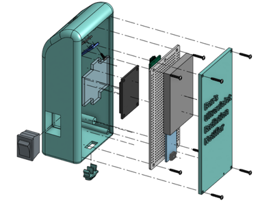

Most of the electronics components are soldered onto a solder board except for the UV sensor, LCD screen, and rocker switch. To make everything fit, make sure to solder the Teensy and voltage regulator on the bottom of the solder board and the battery charger board on top, centered on the last row of the solder board. I had to solder the voltage regulator on the right of the box so it doesn't get in the way of the rocker switch housing.
Since there is not enough space use Dupont connectors for the LCD and UV sensor, I simply soldered wires between their pin holes and the solder board. If you also do not have helping hands like me, you can tape the chips to a table or stand them up on their wires to make it easier to apply solder. Make sure to push the rocker switch into the enclosure before you solder wires between the solder board and its terminals otherwise you would not be able to fit it through the hole. Depending on your 3D printer's tolerance, you might need to scrape off some excess material to be able to fit the rocker switch through (it is a tight friction fit).
Step 6: Assembly - Fasteners and Finishing Details
Before securing the UV sensor and LCD screen to their place, you will want to hot glue the quartz plate and acrylic cover to the inside of the housing. Be careful to not get hot glue on the visible part of the quartz plate or acrylic cover (especially the quartz plate because it would block UV light from reaching the sensor). Although the quartz plate from Alpha Nanotech is too big to fit in the housing (it's 30 mm by 30 mm), I found that I could easily break off a piece by hand (make sure to wear gloves and safety goggles for this) and glue one to the housing.
After gluing both cover plates to the housing and waiting for the hot glue to cool, you can now secure the UV sensor and LCD screen to the housing with the 5 mm long screws. Bend the wires so they are out of the way, and then secure the solder board to the housing with the 10 mm long screws. I recommend putting a few layers of eletrical tape between the LiPo battery and the solder board and cutting off the excess header pins sticking up from the bottom side of the board. This will prevent the sharp header pins and wires from scratching or poking holes into the battery. I also secured the battery itself to the solder board with more tape so it doesn't move around when the enclosure is shaken.

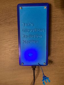

Next, take a small length of wire (I used a blue wire to fit the aesthetic of the blue PLA plastic my housing is printed with) and thread it through the hole on the back cover. Tie a knot on one end of the wire so it does not slip out, and thread the other end through the USB port cover. This way when you remove the cover for charging, it will still be attached to the box and won't be accidentally lost (see image above).
Lastly, close up the box by placing the back cover plate over it and screwing in the remaining four M2 x 10mm screws. Now you are ready to measure some UV index!
Step 7: Charging and Maintenance
To charge the B.U.R.N. Meter, simply unplug the micro USB port cover from the box, and insert your micro USB cable. Make sure you see a red light coming out of the port. If you do not see a red light, that means you might not have plugged in your cable correctly and slight adjustments would be needed. When the device is finished charging, you will see a bright blue glow on the back of the B.U.R.N. Meter. The housing would protect the sensitive electronics inside from dust for the most part, but it is not sealed so don't get it soaked in water. Take your meter outside, keep an eye on the index, and bask away!
