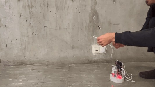

Introduction: The Babble BLASTER
Do you have a friend who just won't stop talking? Or maybe a co-worker who loves the sound of their own voice a little too much? Enter the Babble Blaster, your new best friend for keeping chatterboxes in check!
Powered by an Arduino, the Babble Blaster is a playful, tongue-in-cheek solution to excessive blabbering. This delightful gadget is designed to detect when someone is talking too much (for more than five seconds or so), swiftly orient itself to face the talkative culprit, and then deliver a sassy, pre-recorded message to let them know they've been caught in the act. But that's not all – it follows up with a refreshing (or maybe just surprising!) spritz of water to really drive the point home.
Perfect for adding some light-hearted fun to your office or home, the Babble Blaster is a great project for anyone interested in Arduino, robotics, or just looking for a way to spice up their social interactions. In this tutorial, we'll guide you through the steps to create your very own Babble Blaster, from assembling the hardware to programming the Arduino. Get ready to turn the tables on those talkative types with a splash of humor!
This project was conducted by Nadine Aderhold, Jonas Mertens, and Stefan Lang as a part of the Computational Design and Digital Fabrication seminar in the ITECH master program.

Step 3: Assembling the Robo-guts
The Babble Blaster consists of three main parts
  • a component frame, which helps to place and organize the internal electronic components
  • a lower reservoir for water, which helps to separate the water from the electronic components, and is designed to allow an internal hose to rotate around the entire circumference of the robot;
  • and a cover shell (with googly eyes!), which brings the cute robot to life!
The most important part is assembling the Arduino components onto the component frame. This needs some time and calm hands. All boards and sensors can be screwed with M2 screws directly into the small holes in the 3D print. No nuts are needed. There is a slot for the battery pack, so it can be easily taken out to replace the batteries. Moreover make sure to attach the speaker from the side of the Arduino. Otherwise the cover won't fit. Also make sure to either attach all cables to the Arduino board before placing the water pump in front of it. Lastly check that the rubber hoses fit tightly onto the pins of the water pump. You don't want any leaks!
Step 4: The Final Assembly
After numerous rounds of testing and prototyping, we can finally assemble the full robot!
  • Assemble the Water Reservoir:
Snap the lid of the reservoir onto the fitting column of the water reservoir base. Ensure there is a ~5mm gap between the outer ridge of the reservoir base and the lid to allow for a hose to slot through and rotate around the base.
  • Attach the Air Pump:
Attach two pieces of PVC pipe to the end of the air pump.
Fit one end of the supply hose through the hole of the component frame, and down into the water reservoir.
  • Place the Outer Shell:
Gently place the outer shell around the robot, taking care not to disconnect any wires!
  • Fit the Nozzle:
Fit the other end of the PVC pipe through the nozzle hole in the robot shell and attach the nozzle.
Note: We originally wanted the water to spray out of the robot mouth but ran out of space due to the complex internal wiring, and were worried about water leakage. We decided to drill a 5mm hole in the robot shell above its eyes so that the nozzle attached from the outside of the shell, like a unicorn horn.
Your Babble Blaster is now ready to go! Enjoy watching it in action as it humorously interrupts those who talk too much.
