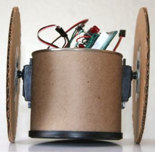

After I saw that the children loved my little CanBot1 robot and they wanted to take one home ... but I couldn't sell them because it was a bunch of loose parts so I began exploring how to make the CanBot1 into a product using SolidWorks for 3D Modeling & Designing;
https://www.youtube.com/watch?feature=player_embedded&v=YMFBy28ruAQ

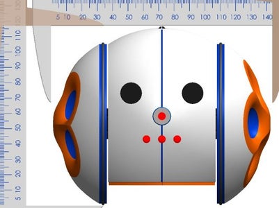

The BallBot1 was born;
http://www.r2pv1.net/BallBot1.Project/BallBot1-01+Calipersc.jpg

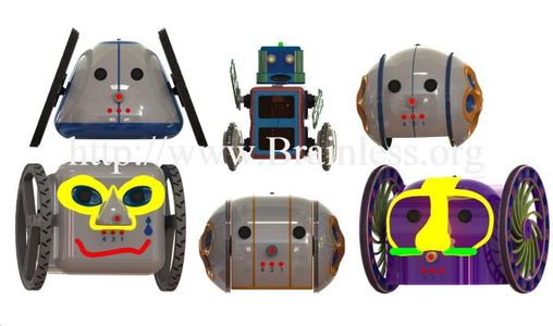

Then as I wanted to build some pre-production prototypes I made a few more changes;
https://www.youtube.com/watch?v=Fq5mXCvl3YA&feature=player_embedded

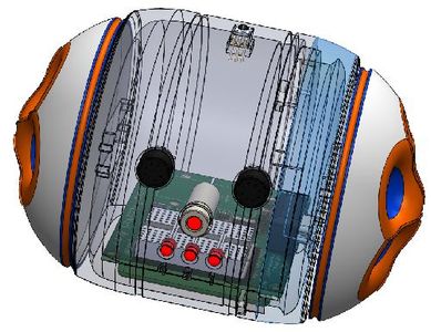

Now I can fit the Parallax.com Serial HomeWork Board into the robot along with a few LEDs, a laser, a photo sensor and two piezo speakers. The real secret to the product is the super smart program that creates a small 15-word language for users to communicate back 'n forth with the robot.
http://www.brainless.org/R2Pv1.net/BallBot1.Project/BallBot1P+ParallaxHomeWorkBd.jpg

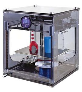

Now it's time to start printing robot parts! So I got a 3D Touch printer from BitsFromBytes;
http://www.bitsfrombytes.com/usd/sites/www.bitsfrombytes.com/files/imagecache/product/BFB-3DTouch-Smoke-3D-Printer_0.jpg

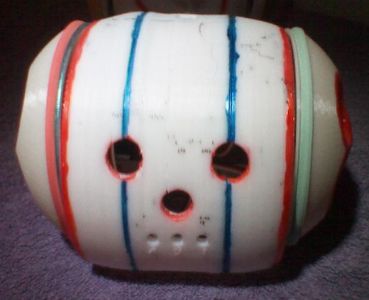

Step 5: Print Quality Less Than Desired ...
The printer has two heads ... one for PLA raft & support material and another head for ABS printing plastic for my robot body parts;
http://www.brainless.org/R2Pv1.net/BallBot1.Project/IMG_20120207_194803.jpg
http://www.brainless.org/R2Pv1.net/BallBot1.Project/IMG_20120207_194831.jpg
http://www.brainless.org/R2Pv1.net/BallBot1.Project/IMG_20120207_194732.jpg

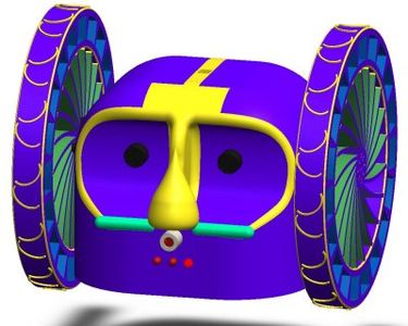

Step 7: Prettier Results ...
Now I'm getting very pretty results!
http://www.brainless.org/R2Pv1.net/BallBot1.Project/zBallBot1P-Printing2.gif
And I'm seeing my designs from a new angle; http://www.brainless.org/R2Pv1.net/BallBot1.Project/Wheels4BallBot1Pc.gif

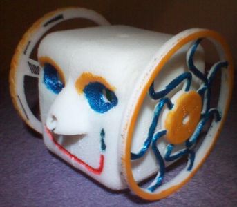

Step 9: Hand Painting Is for Naught!
... maybe add up to 5-colors on one robot like my BlockHead1 robot;
http://www.opecofthewest.com/MultiMedia/BallBot1/BlockHeads2Tears1K.jpg
and as you can see I'm not very good at hand-painting in the features;

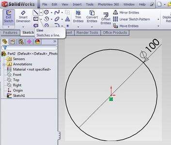

Step 10: How to Create a 3D Model Using SolidWorks ...
Okay, by now you must be frustrated and want to ask; "How do I get started designing or 3D Modeling with SolidWorks?" SolidWorks is extremely easy to use ... all you have to do is learn the tools by playing with them after maybe a 10-minute lesson on how to get started.
Here's a quicky lesson;
File - New - Part
Sketch Tab - Sketch - Select any Plane
Select a basic tool like the circle ... then select the red triad origin in the middle of the screen
1-Click the mouse changes - move the mouse away from the center and see your circle grow ... click to stop growing.
Now hit the ESC key to exit the tool.
Now select the Smart Dimension tool next to Sketch ... click on the outer edge of the circle and move the mouse around and pick a style size label and click again.
Type in the diameter of the circle you want and hit ENTER
Now select the solid straight line tool ... moving your mouse near the bottom of the circle you will see the mid-point highlight ... click on that then drag your mouse to the top mid-point of the circle and click again ... then hit ESC to exit the tool.
Now click on the Trim Entities tool ... using the left mouse button held down drag it over the left half of the circle but DO NOT cross the vertical middle line ... then let go of the mouse. You have now made a half-circle. Hit ESC to exit the Trim Tool.
Click on Exit Sketch in the upper left corner.
Click on the Features TAB
Click on the second tool "Revolved Boss/Base"
Now click on the vertical bar in your half-circle sketch and see it turn into a ball.
Click on the GREEN check mark either in the upper left or the upper right of the screen to exit the tool and see your 3D Solid Model of a Ball.
Click on Front in the left column ... then the little arrow pointing Up and see you are now looking at the front of the ball.
Okay, now you know how to make solids ... next task is to cut using sketches and tools ... that's all there is to learning SolidWorks for 3D Modeling.
The hardest part is coming up with things to sketch for practice ... What I did to learn is take a walk outside ... whenever I see a little plastic or metal thing on the ground I pick it up, take it home, measure and sketch the object in SolidWorks until I've essentially become a SolidWorksMagi.
Just think of it as clay ... you add and subtract clay until you get the shape you want.
