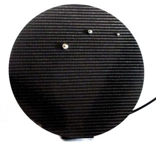

This is my design of a minimalist clock. It shows the time via small steel balls that move across a flat carbon clock face as if by magic. There are no numbers or pointers on the clock face.
Inspired from tomatoskins' "Mesmerizing Magnetic Wall Clock" in Instructables I designed this Ball Clock which is mostly 3D printed. The principle is similar to tomatoskins solution but my design is completely new and comes up with additions and a new electronic and software.
The ball moving mechanics are easy to adjust with moveable ball bearing holders. The complete case and the gears are fully 3D printed. So "non-wood-workers" can build this clock too. The clock face is made of a round carbon fiber sheet with a shiny glossy surface which looks very technical and modern.
The Features:
- detachable, freely moving steel balls for hours, minutes and seconds to show the time
- glossy carbon fiber sheet as clock face
- all parts 3D printed
- customized PCB with all electronic components in one PCB
- arduino sketch with self-calibration and initialization
- seconds wheel can be switched off if you want it less esoteric
- buttons for adjusting the time (hours and minutes), start a calibration and switching the seconds on and off

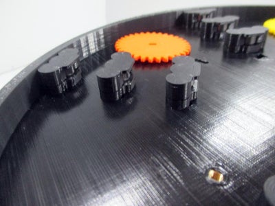

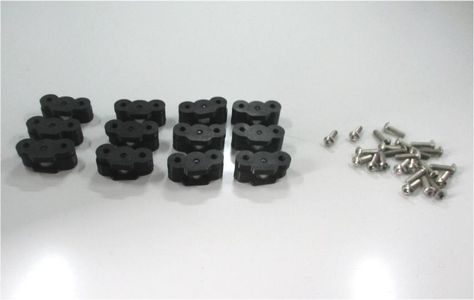

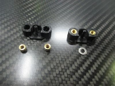

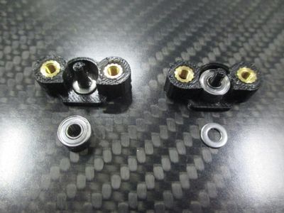

Step 1: Prepare Ring Retainers
Assemble the 18 ring guides as shown in the pictures.
First press the melt-inserts with a soldering iron into the two outer holes of part "HalterBearing.stl". The temperature of the soldering iron should be in the range of 370 °C for PLA.
Add a M3 washer to the plastic pin in the middle, than one bearing 3x8x4 mm and another washer M3. Cover the whole thing with the printed HalterBearingUpper.stl.

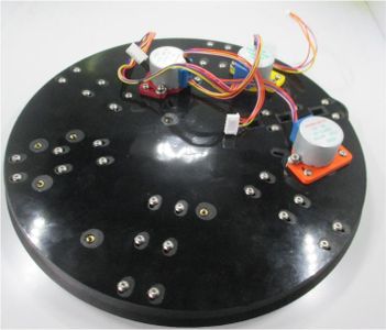

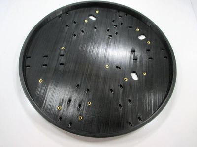

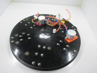

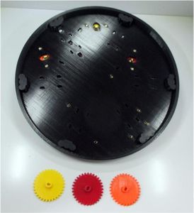

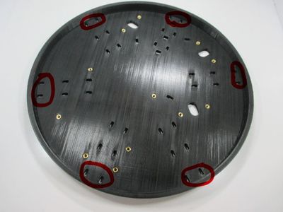

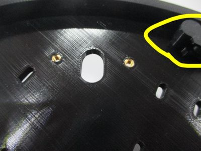

Step 2: Prepare Base-Panel

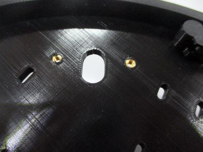

Press twelve of the inserts into the marked holes of part BasePanel.stl with a soldering iron. You can see the positions at the picture.

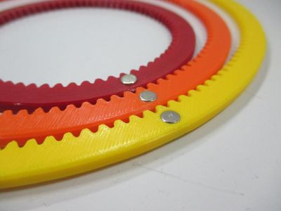

Step 3: Prepare Geared Rings
Press a small cylindric Nd-magnet 5 mm Diameter x 8 mm Length into the hole of each geared ring.

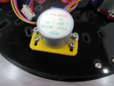

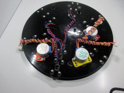

Step 4: Prepare Stepper Motor Supports
Press the inserts into the motor mount and assemble the stepper motor with two washers M3 and two M3x5mm hexagon socket head screws. Repeat this for each of the three motors.

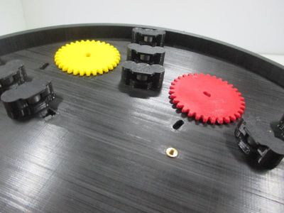

Step 5: Attach Second-Ring Retainers
Now assemble six of the former prepared ring holders from Step 1 with two M3 x 12 mm bottom head screws each. Push the screw from the backside through the elongated holes in the most outer position and fix the retainers with them.
You don't have to tighten the screws too much. The whole retainer has to be moved later.

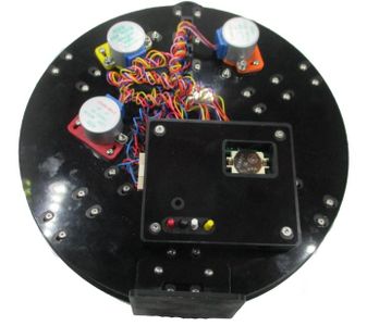

Step 6: Mount the Stepper Motors
Take the stepper motors from Step 4 and mount these with two M3x8 mm button head screws from the backside into the base panel. The right position can be seen in the pictures or the assembly video.
After that press the drive gears (parts Seconds/Minutes/HoursGear.stl) onto the motor shaft. The flat side must face-up.The drive gears must sit very close to the baseplate but should not touch it. Some fine adjustment could be neccessary. The drive gear must rotate freely without scratching the bottom.

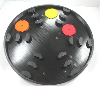

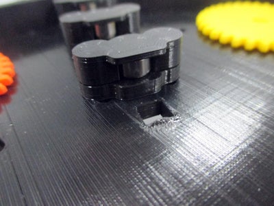

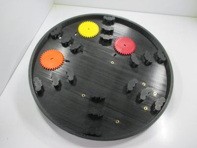

Step 7: Mount All Retainers
Now add the remaining twelve retainers (from Step 1) in the same way as in Step 5 for the minutes and hours positions. Fix them slightly with 24 bottom head screws M3 x12 mm, but not too much. They must still be movable.

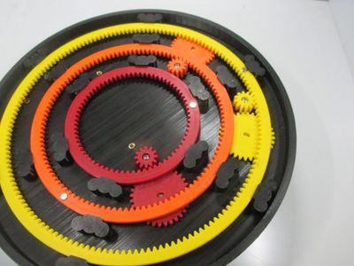

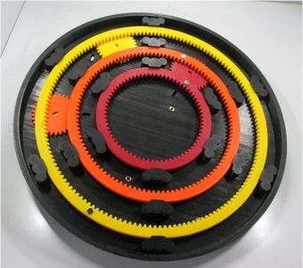

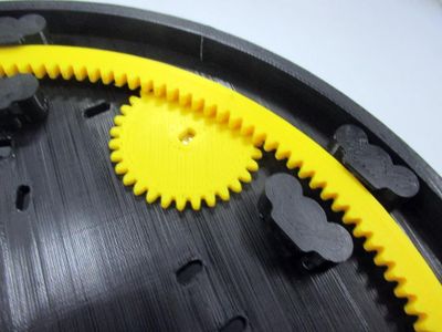

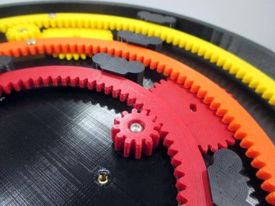

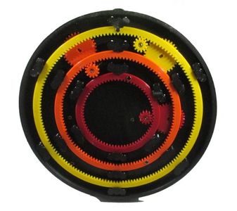

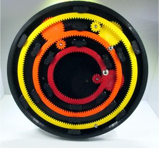

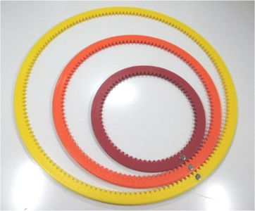

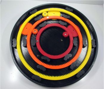

Step 8: Mount the Geared-Rings
Next step is assembly of the geared ring for seconds (the yellow one). Lay it in the gaps of the ring holders and slide them slightly to the center of the baseplate. You should try to stay here as concentric as possible. Perhaps you have to loose the mounting screws of the retainers again a little bit. Adjust the holders in a way, that the seconds geared ring is freely rotateble but does not fall out of the retainers. A slide contact to the bearings is acceptable, but the ring should not block. Take care in adjusting this right, it will save you trouble later.
Repeat this for the orange Minutes-Ring and the red Hours-Ring.
The result is shown in the pictures.

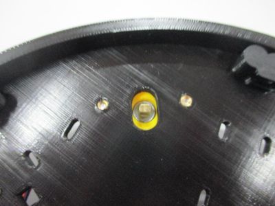

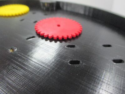

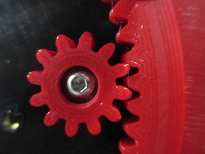

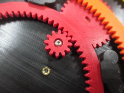

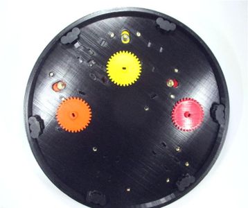

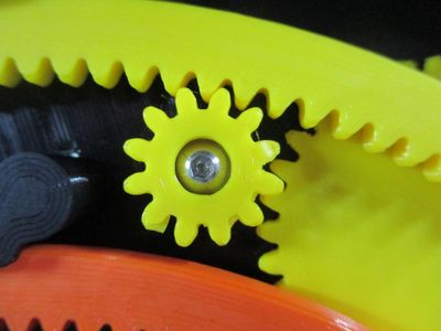

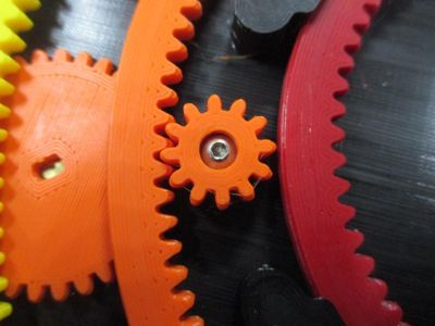

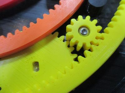

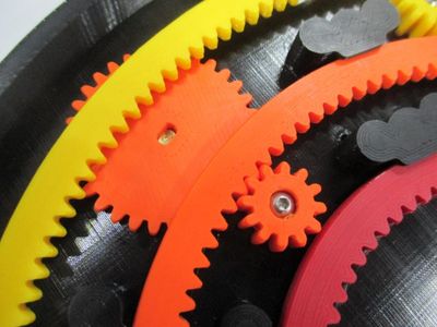

Step 9: Prepare the Small Gears (Ritzel-Parts)
Next assemble the small gears (Ritzel-Parts). They consist of the printed gear (Seconds/Minutes/Hours-RitzelV2.stl), two bearings 3 x 8 x 3 mm, a button head screw M3x16 mm and a washer M3. Simply press two bearings into the gear and push the screw through both.
Step 10: Assembly of the Small Gears
The Ritzel-Parts will be assembled into the elongated holes of the baseplate and they should touch both gears (Geared-Ring and Motor-Gear) of the same color to build a geared transmission. Take care - especially with the orange ritzel - that these do not touch the outside of the other Geared-Ring. In this case you have to loose the related ring holders again and move the ring gear a little bit to achieve the needed space. The stepper mounts are movable either in a limited range. Fix the ritzel gears with a washer and a nut from the other side of the holes. The result should look like in the pictures.
Attention again: Take care that the parts gear into each other but not that strong that a smooth motion is not possible anymore. A little bit of sensitivity is neccessary here.

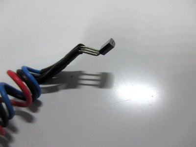

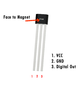

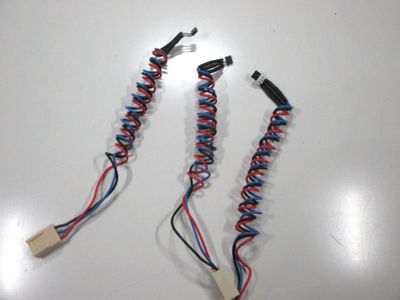

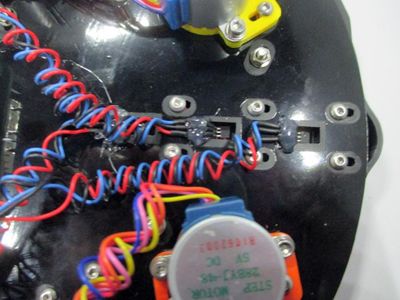

Step 11: Mount the Hall Sensors
Solder three wires (red, blue, black) on each Hall-Effect sensor. If you look at the labeled side, first is red (+5V), the middle black (GND) and the right blue (SIG). Secure the joints with heat shrink tubes. Bend the wires near the sensor in 45 degree, with the labeled side downwards (see picture). Now glue these sensors in the rectangular holes of the basepanel. You can use a small portion of hotmelt glue for that. Take care, that no glue drops through the hole onto the geared ring underneath the hole. The labeled side of the sensor must face downwards.

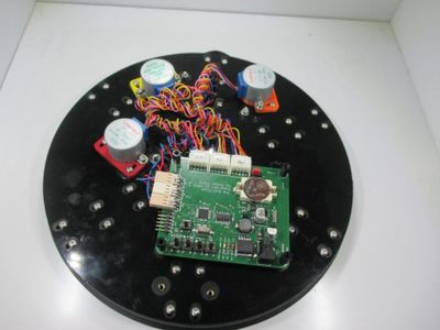

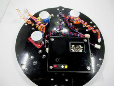

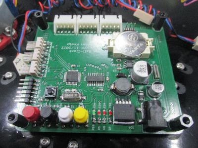

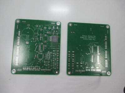

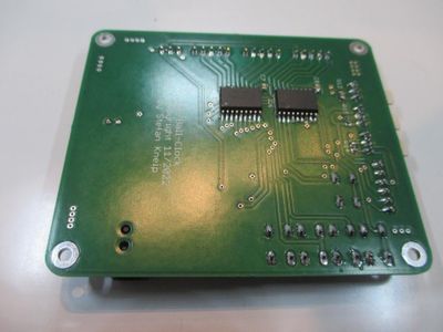

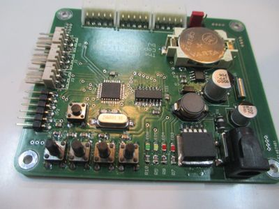

Step 12: Mount the Electronics / PCB
Some words to the Electronics:
You need a special PCB to assemble this clock. You can order one from PCB etching service (Eurocircuit or similar) with the attached *.brd-Files (See Folder Electronics on Github), but you have to solder the components by yourself.
The circuit is based on Arduino-principle. You need a Atmel 328P-AU (TQFP) with bootloeader programmed to write the arduino sketch on it. So before you solder the main chip you have to flash a bootloader on it. There are many instructables here on this platform how you can do that. Most of them are for the DIP-Versions of the Atmel 328P. As I use this chip very often I designed my own programmer for that. I will come up with another instructable regarding this point.
Take the BOM for the components from the schematic and the file BallClockBOM.txt.
Here is a video, how I assembled the PCB, for those who are not familiar with SMD soldering:
Mounting the PCB:
Take four Nylon pillars M3 x 8 mm with threads and screw them into the dedicated inserts. Put the colored caps onto the pushbutton pins of the PCB. Now fix the PCB with four Nylon pillars M3 x 12 mm. Fix at least the PCB cover (ElectronikCover.stl) with four ISO10642 M3x8mm hexagon socket countersunk head screws.

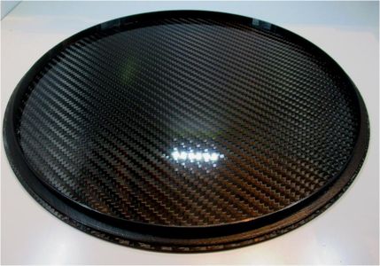

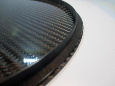

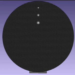

Step 14: Prepare the Carbon-Face-Plate
Glue the part HalterFront.stl with a small portion of plastic glue or super glue (I used Uhu Hart Kunststoff) onto the carbon face plate. Take care the carbon plate and the Halter-part are concentric.
One remark regarding the carbon face plate:
Do not take the bait and try to cut the round face plate sheet yourself. Carbon fibers, especially the dust of the fibers, which occurs during cutting, is very hazardous and can cause lung cancer. Whereas the ready made round-cut face plate is not dangerous nor harmful.

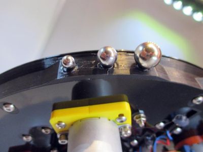

Step 15: Balls Garage
Press three cylindric Nd-magnets 6 x 3 mm into the side holes of the basepanel provided. Use some super glue to fix them if they do not snug. These magnets are to store the magnets during cleaning the face plate or transport. This step is optional.

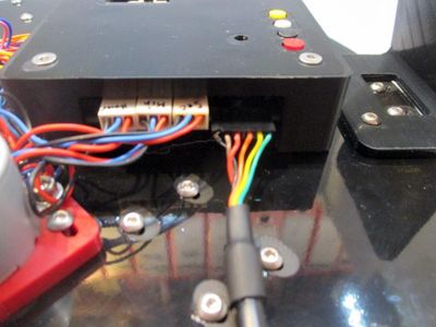

Step 16: Wiring Motors and Sensors
Attach the appropriate crimp connectors to the cable ends of motors and hall sensors. The pictures show you how they get wired to the ballclock board.
If you bought the steppers with driver PCB included they will have the right plug already mounted. But take care of the right wire assignment. On my PCB the stepper assignment is as follows (yours could be different!):
5 Pin JSH-XH:
1 - +5V red
2 - Coil 1 orange
3 - Coil 2 yellow
4 - Coil 3 pink
5 - Coil 4 blue
Add the jumper in JP1 towards the JST-XH05 connectors to supply the steppers with 5 V. If you have 12 V steppers, you can jumper JP1 in the other direction to supply the drivers with 12 V (if you have a 12 V wall power supply). Take care: The above mentioned steppers are for 5 V only!

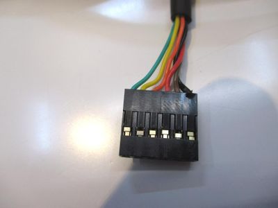

Step 17: Flashing the Processor
Flashing the processor is quite simple due to the Arduino environment.
Tool you need:
FTDI-USB-Programmer (This is only an example).
Plug your Arduino FTDI programming tool into the 6- pin programming input header on the BallClock board (Pay attention to the right direction of the 6-Pin header, GND is at PIN1 of JP2) . Here is an instructable how programming the arduino with FTDI-programmer has to be done: https://www.instructables.com/Program-Arduino-Mini-05-with-FTDI-Basic/.
Start your programming environment (PlatformIO in my case).
Download the code from github: https://github.com/reparator/The-BallClock
Put the downloaded libraries (from GitHub-folder "Code") into the appropriate folders of your programming environment. Select as target device "Arduino UNO". Take care to use the right serial port.
Load the ballclock code (file main.cpp in the software folder), compile and upload it to the ballclock board.
Thats it!

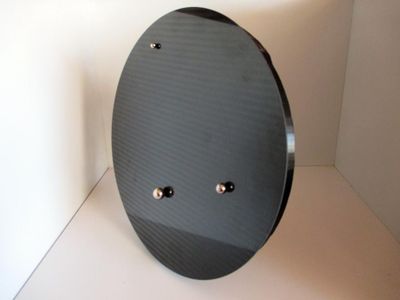

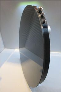

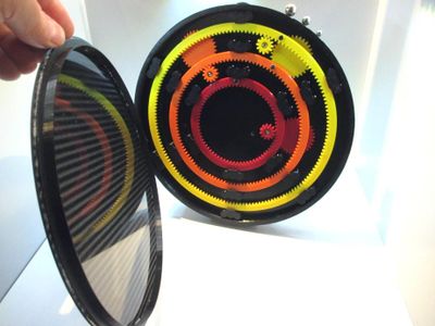

Step 18: Mount the Carbon-Face-Plate
The former prepared Carbon face plate is now attached to the base plate from the front. It should stick snug without glue and is removable.

When calibration is finished, attach the balls at 12 o’Clock Position, than press the white button again.
The clock should run now.
