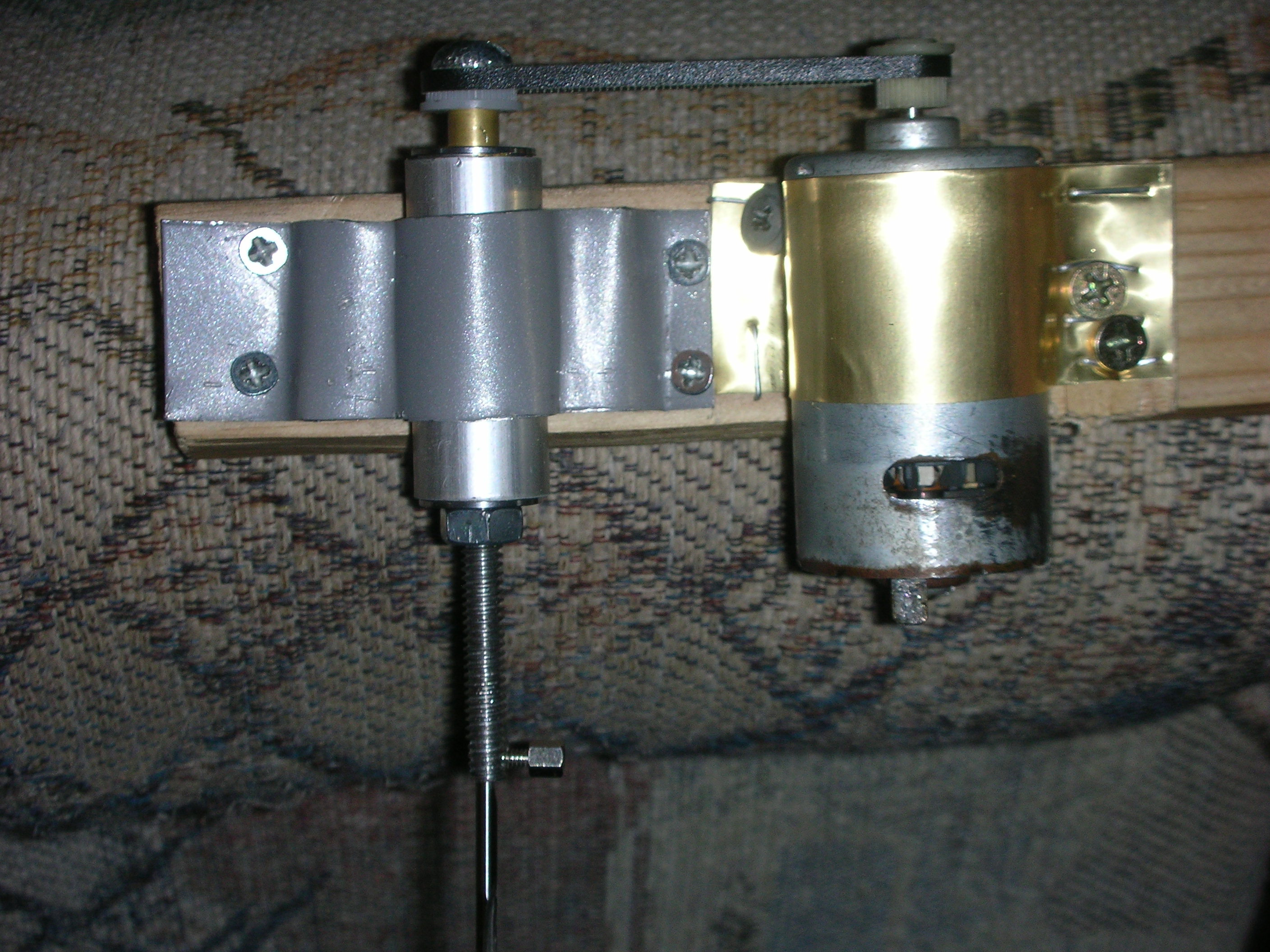

Step 2: Build the Active Center Point, and Sliding Block.
The sliding block is just another piece of the 2x6, with aluminum guides along the bottom, and the aluminum mounting brackets screwed down to it. This slides along the base 2x6, but with significant friction, which is as designed.
Those who've seen my DIY router guide will note that I obviously re-used the rotating 1/4"-20 bolt and bearings assembly that previously housed the Dremel router bit. Since that's true, please reference the instructions from step 3 of www.instructables.com/id/Cheap-DIY-dremel-compatible-router/step3/Prepare-the-rod/. (In the text edit boxes on Instructibles, copy/paste does not work.)
Instead of mounting a router bit to the end of the rod, mount a smooth point to it. I used one of those chrome-coated brass spikes that you can attach to clothing for that "punk rock" look, since I had some around. I bought mine around 10 years ago, at Evangeline's in Sacramento, CA (You don't *know* me! lol). They were about $5 for a twelve-pack, as far as I remember.
The mounting brackets here are designed, again, for maximal strength and rigidity from the aluminum that they're cut from. Also, the height at the center of the shaft is the exact same height as the center of the drill's shaft, 6", when the block is mounted flush against the longer 2x6.
It would be best to use a C-Clamp to hold the block to the longer 2x6, when doing heavier-duty work.
