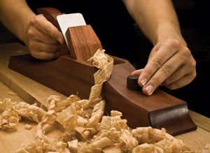

Step 3: Hand Planes
No.5 or 5 1⁄2 JACK PLANE. The jack plane is a good all-rounder that’s just long enough to flatten timber while also being useful as a general purpose tool. The 5 1⁄2 is slightly wider than the 5 and it’s really down to personal preference which version you go for.
No.4 or 4 1⁄2 SMOOTHING PLANE. The smoothing plane is very flexible in its uses and ideal for taking very thin shavings prior to finishing. As above, the 4 1⁄2 is wider and heavier than the 4.
Andy King says: “To start with, you’ll find either a jack or a smoother sufficient. My preference would be a smoother, unless I was leaning more towards shooting and straightening work. You can use it as a block plane to a degree too.”
