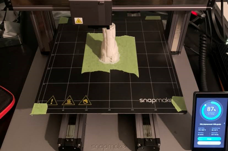

Before beginning your print, you need to physically prepare the printer. The most important part of this step is making sure that the printer bed is completely level. If the bed is not leveled properly, the print might be completely messed up. Some printer beds can be automatically leveled, but some have to be manually adjusted, depending on what type of printer you are using. For the Snapmaker A350, the bed can be automatically leveled. Additionally, the printer needs to be warmed up to the right temperature before beginning the print. When using PLA filament, the printer bed should be warmed up to 60C, while the nozzle should be warmed up to 200C. Once this step is complete, you can hit the print button.
Step 10: Monitor Your Print

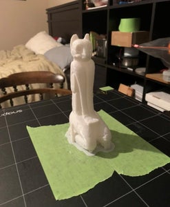

Most prints take several hours to complete. During this time, you should monitor the print to ensure that things are going smoothly, especially during the initial layers. If you notice that the first layer is not properly adhering to the bed, you may want to retry the print with an added layer of painter's tape to create better adhesion, as pictured above. Raising the temperature on your printer may also help with this issue. If you notice that the lines of the first few layers look rough and uneven, try adjusting the nozzle further away from the layer. If you notice that the lines look globby, try adjusting the nozzle closer. Now it's time to wait!
Step 11: Finishing Up
Once the print is finished, remove it from the printer bed using a scraper or pallet knife. Carefully remove any supports and the bed adhesion layer. Use pliers to help gently cut the plastic away if necessary. For a more complete look, sand any rough areas and paint your object to resemble the original artifact. Congratulations on completing your first print!
