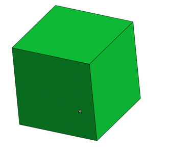

Step 1: Shape the Outside
Take your block of wood and use the bandsaw to make all the edges squared. This makes the rest of the process much easier. Then cut out the shape of the outside of your box.

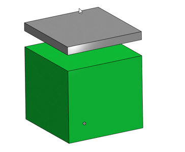

Step 2: Make the Lid
Next cut the top off your piece of wood. This will become the lid. I typically keep it about 1/2 inch thick. Side note: I am using a square box for this demonstration but all the same principals apply to any other shape.

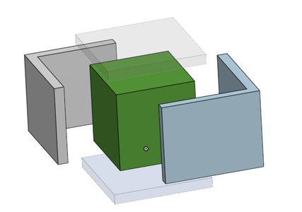

Step 4: Cut the Sides
Next, you want to cut the sides. With a square box, you cut in from opposite corners as shown. With a circular box, you only have to cut in from one side.

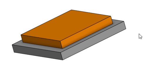

Step 5: Cut the Plug
Now take the middle chunk, (the piece that was left after cutting the sides) and cut a piece off the top. This will be the plug (the bit that stops the lid from sliding off).

Step 7: Glue the Lid
Once the glue on the box is dry, use it to center the plug so that the outside of the lid lines up with the outside of the box. Glue the plug to the lid. Then sand it when the glue is dry.
