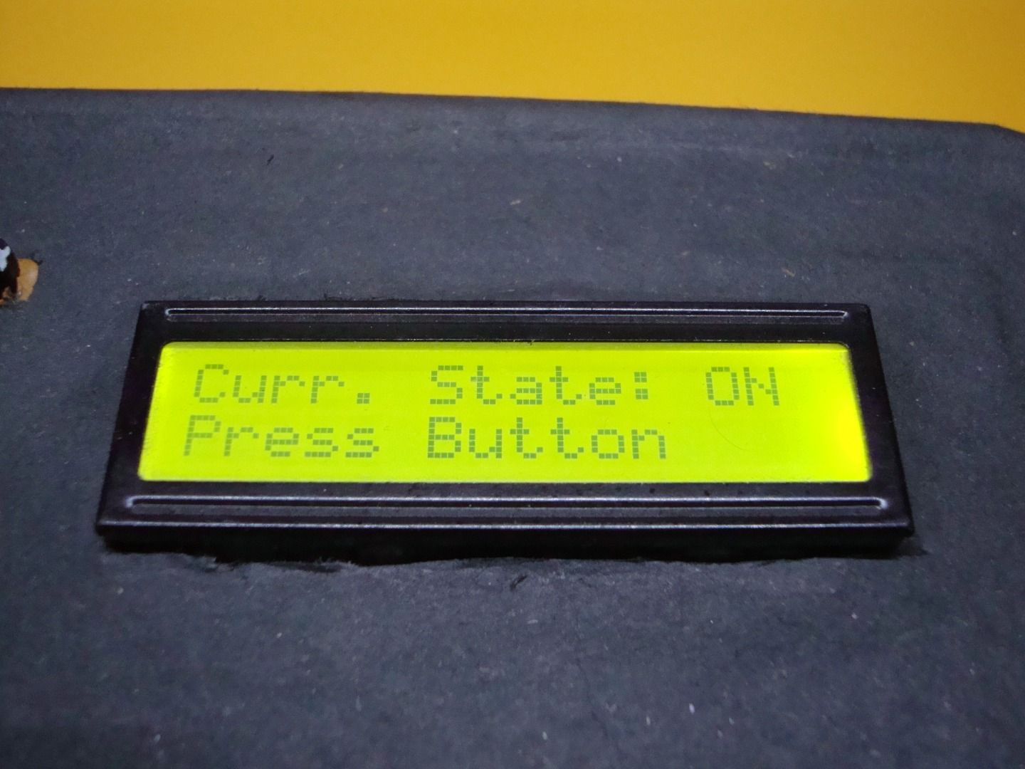

1) Toggle Mode: Simple mode that switches the power outlet on when the first button is pressed. On again pressing the button, it switches off. In simple words, it acts as a toggle switch. I added this mode for some situations when I wanted to use it just like an extension cord by not using any of the sensors.

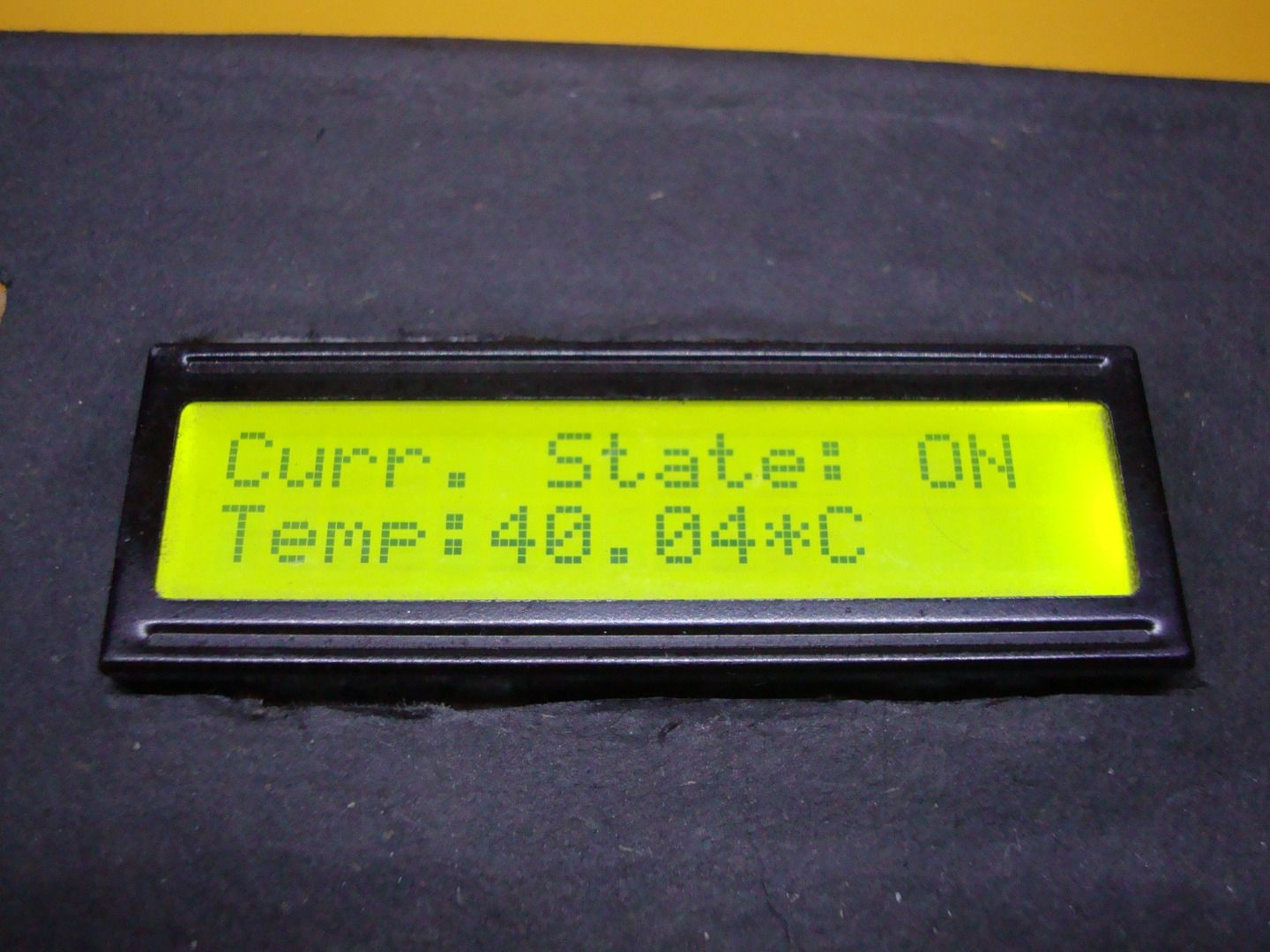

2) Temperature Sensor Mode: Uses the temperature sensor to control the outlet by switching it on when the actual temperature crosses the set threshold temperature. This mode can be used to run, ceiling fans, desktop fans, room coolers, low power air conditioners and any appliance related to temperature. The arduino code can be modified to use it for heating appliances.

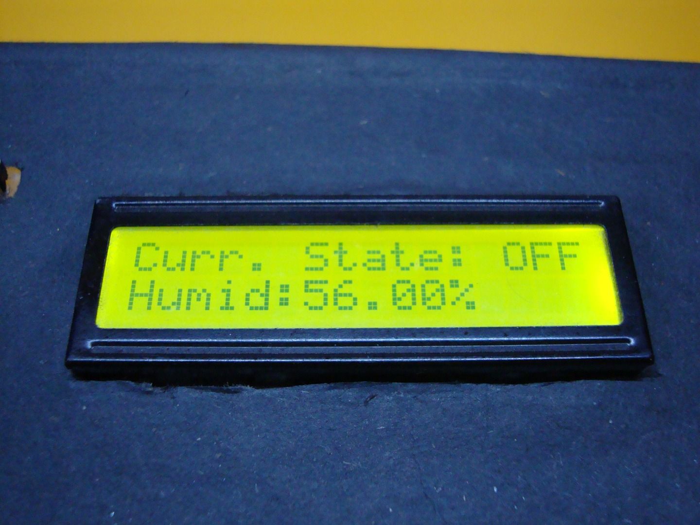

3) Humidity Sensor Mode: Uses the humidity sensor to control the outlet by switching it off when the actual humidity crossed the set threshold humidity. This mode can be used to control any humidity related appliances especially room coolers. The reason is that room coolers when used for a long time increase the humidity of air causing less cooling and uncomfortable feeling. This mode will turn it off in such a case which will give better cooling.

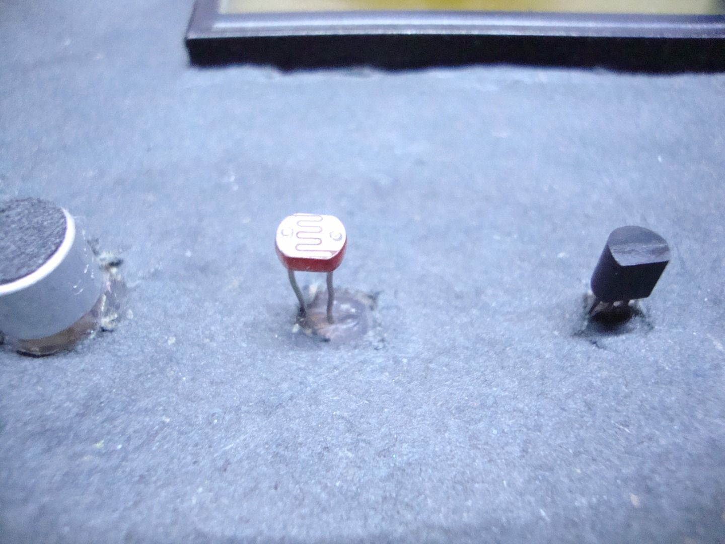

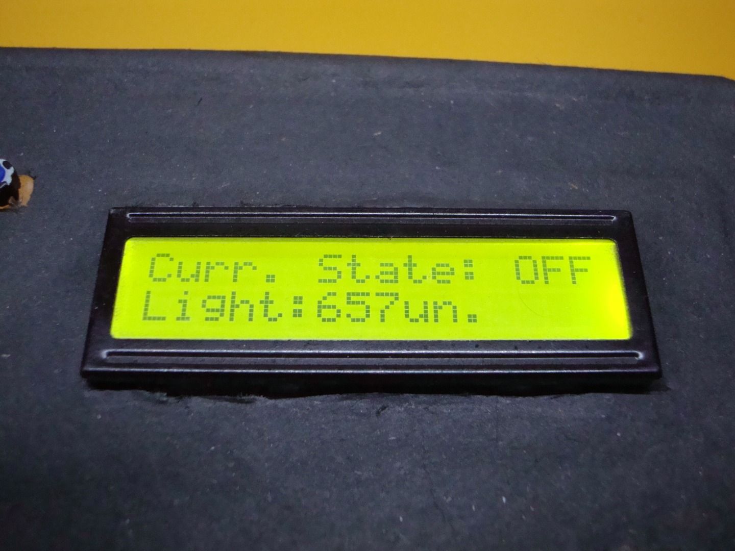

4) Light Sensor Mode: Uses an LDR to find the light of the place and switch the outlet on when the light becomes less than the set threshold intensity. LDR is not accurate to measure light in S.I. unit so I didn't use it but used the word 'unit' for it. The recommended threshold is 250 units. This mode can be useful to operate desktop lamps, ceiling lights and even a bell to wake you up in the morning. Any other light related appliance can also be powered.

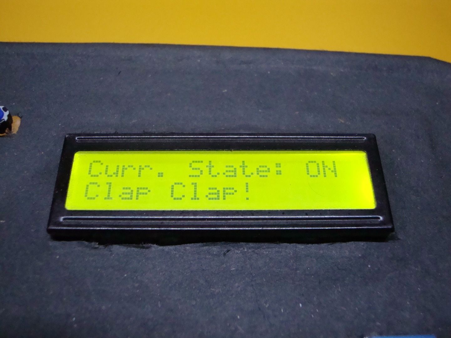

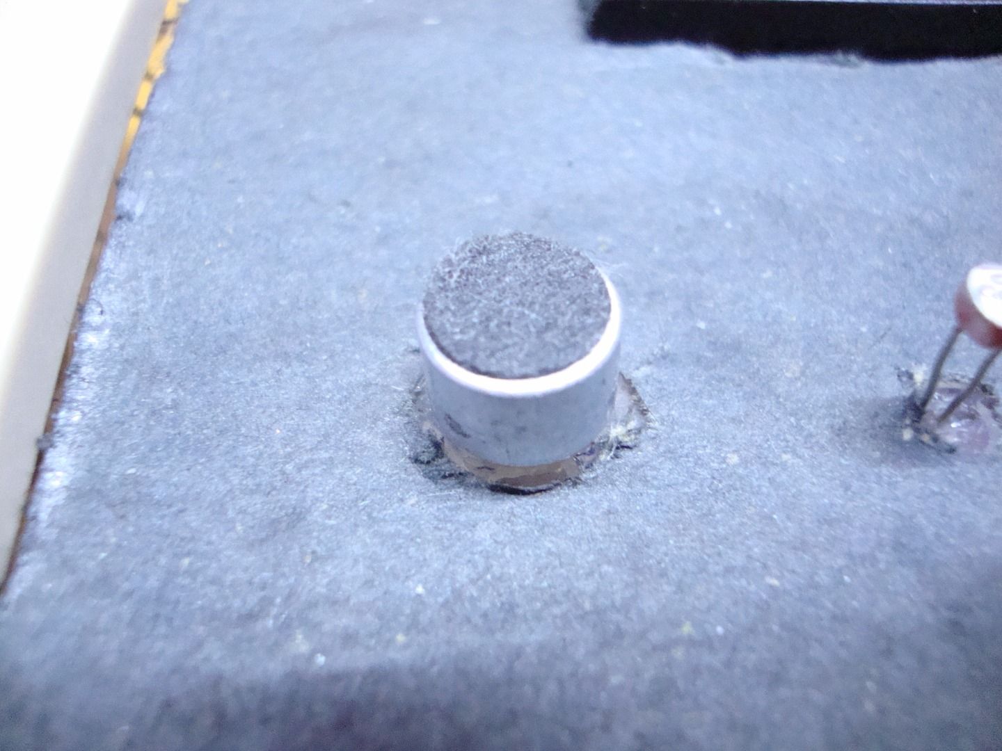

5) Clap Sensor Mode: Uses an Electret Microphone to detect loud noises and switch on an appliance by clapping. Clapping again will switch it off. Use this mode to control any appliance by just clapping. This is similar to 'The clapper' used in old times.

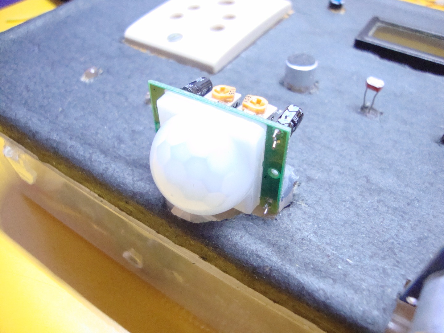

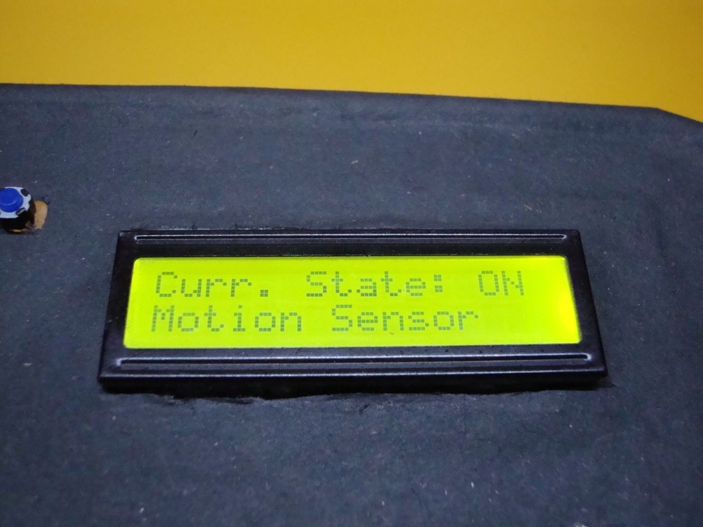

6) Motion Sensor Mode: Uses a PIR motion sensor that detects the motion of a human being. Use this mode to turn on an appliance by just waving your hand in front of the box upto a range of 6 meters. Wave your hand again to switch it off. This mode can be used to control almost any appliance.

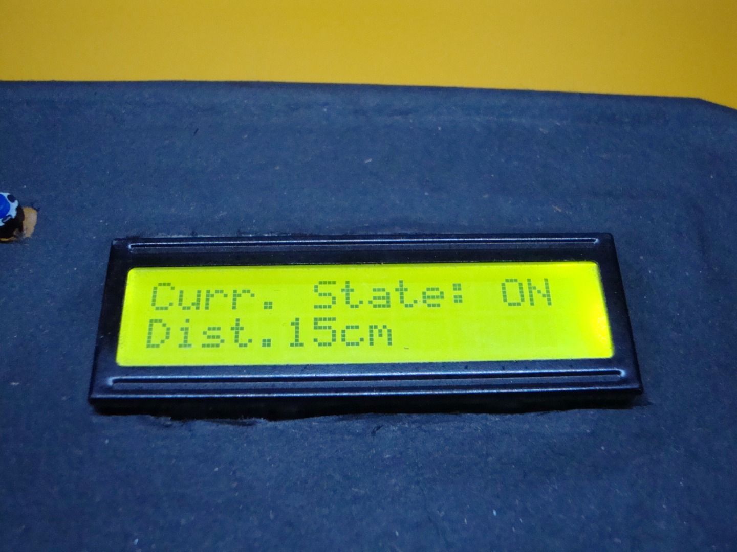

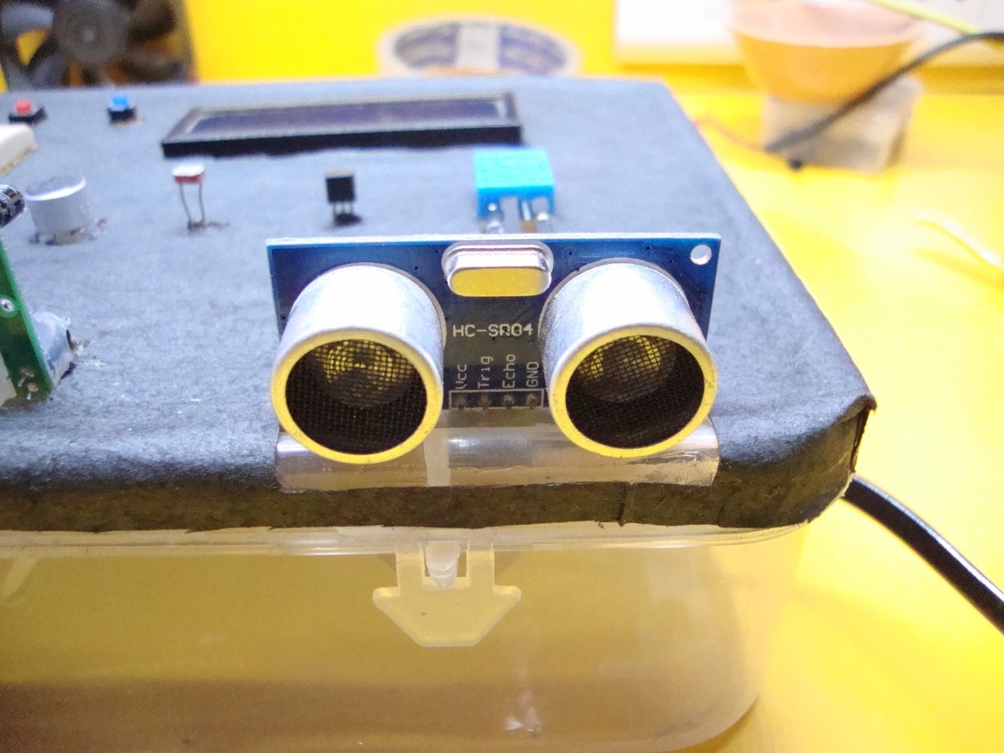

7) Presence Sensor Mode: Uses an Ultrasonic distance sensor to check your presence near the box. It works by switching the outlet off when the distance is more than the set threshold distance. The threshold distance should be a little more than the distance between you and the box when you are sitting. This is the best mode from all of them as it helps you to save energy by switching off the appliance when you are not sitting in front of it. Use this mode in your workshop or when you are studying. It can be used to power desktop fans, reading lamps, soldering iron, hot glue gun and many more tools and other appliances.

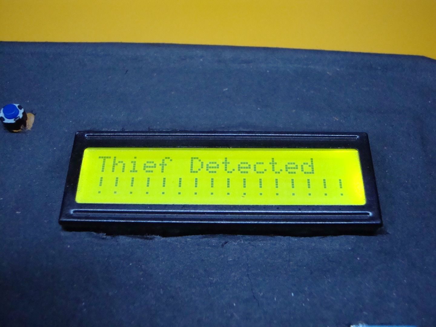

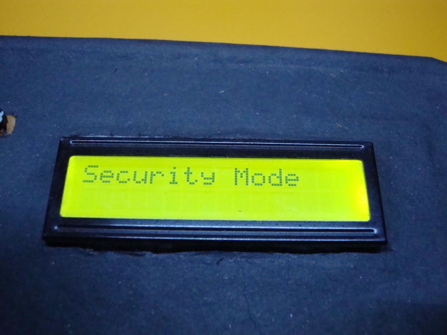

8) Security Mode: This mode can be used to protect your valuables at night when you're sleeping. It uses the motion sensor to detect the motion of a thief at night. On detecting a thief, it switches on the outlet and sets the buzzers high to wake you up. You can connect a light or a loud bell to wake you up easily.

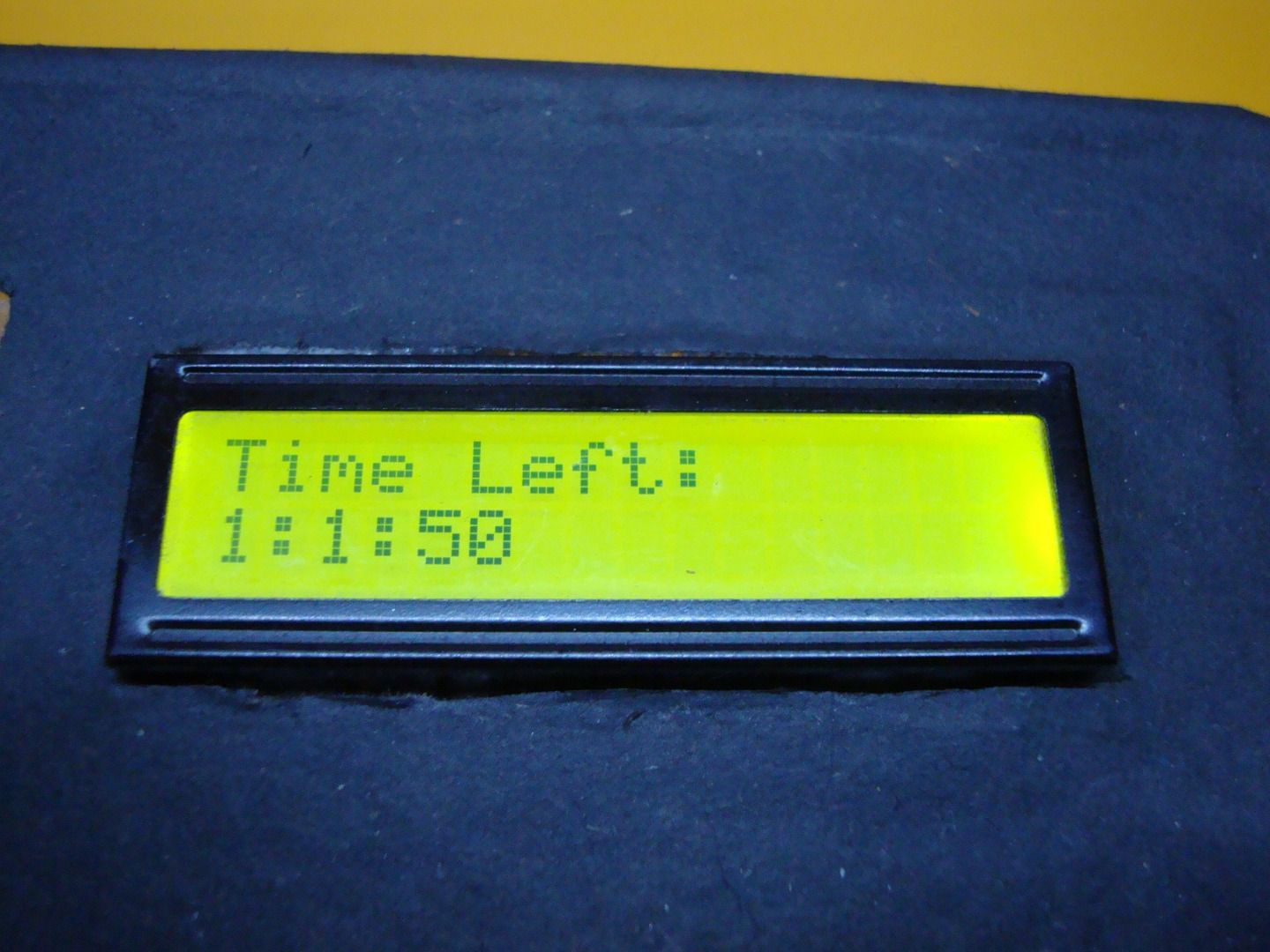

9) Timer Mode: Set the number of hours and minutes you want your device to be on. This timer mode will help you save energy. Control almost any appliance with this mode.

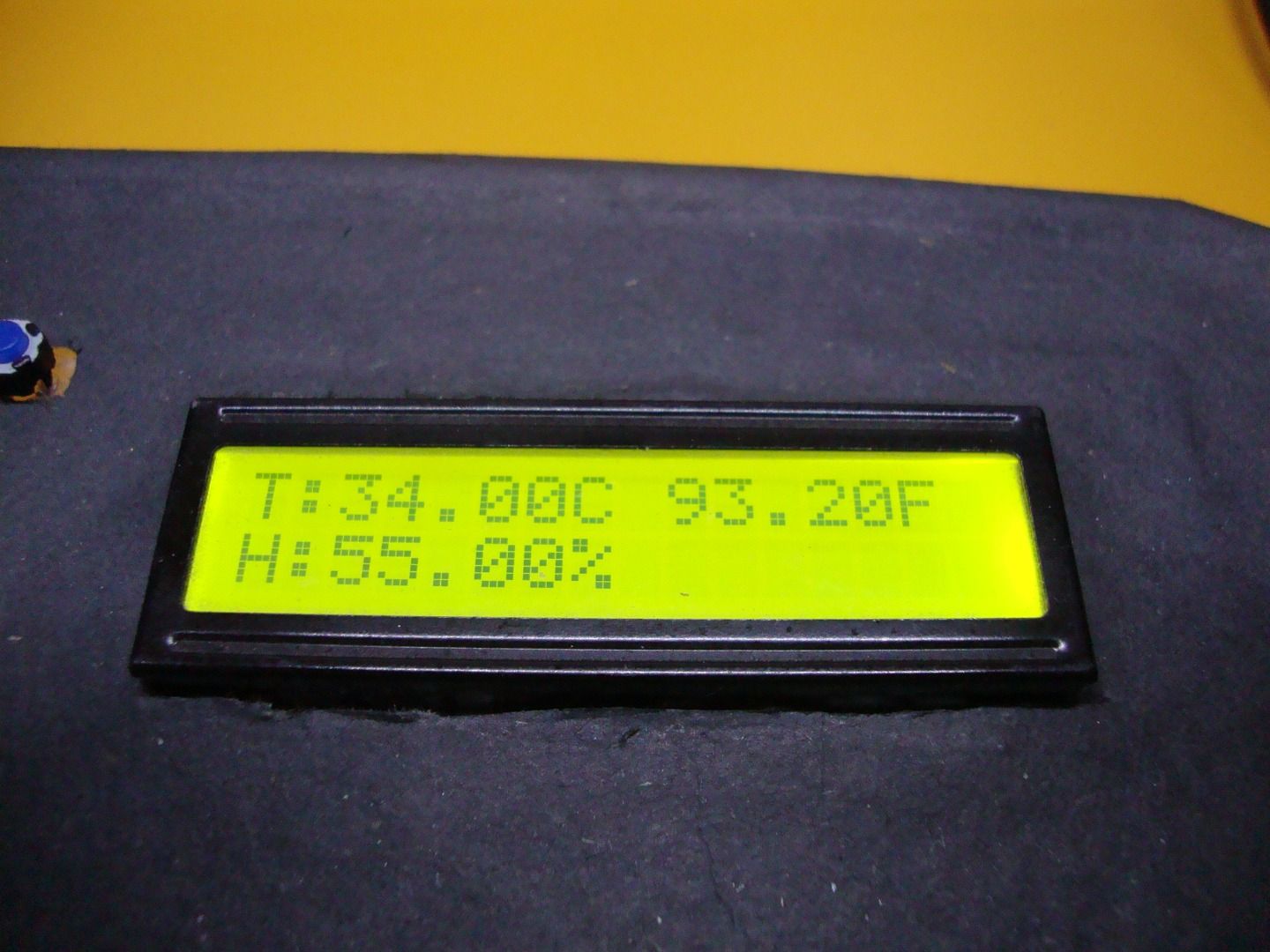

10) Weather Display Mode: A simple mode that displays the temperature and humidity of the place it is kept. It displays it on the lcd as well as sends through bluetooth to be seen through a laptop or smarphone.

- The security mode will beep the buzzer even if you or any other person (who is not a thief) passes through the front of it spoiling the sleep of your family members.

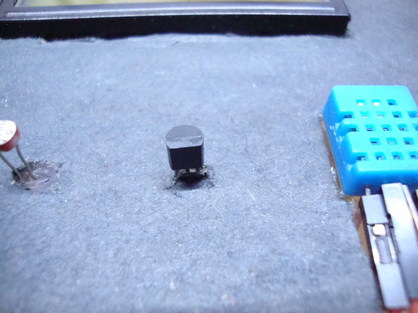

- Temperature sensor (LM35): Gives a voltage on one of its pins which becomes high or low depending on the temperature of the sensor. The arduino reads the voltage and converts it to readable temperature.

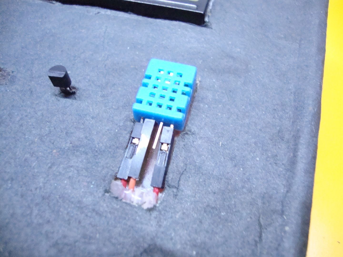

- Humidity sensor (DHT11): Gives a certain clock signal of both temperature and humidity. The arduino converts those signals to readable temperature and humidity. (Used here only for humidity).
- Light sensor (LDR): Gives a high resistance when placed in dark and low resistance when placed on a place full of light. The resistance changes with change in intensity of light. The arduino reads the resistance.
- Clap sensor (Electret Microphone): Gives a low power signal when a loud sound is detected. The arduino detects the low signal and sets the outlet high.
- Motion Sensor (PIR Sensor): Detects the motion of a human and gives a high output when detected. Actually detects that radiation given out by a human.
- Presence Sensor (Ultrasonic Distance Sensor- HC-SR04): Transmits an ultrasound that goes, reflects and comes back. Arduino measures the time taken by it and gives the distance. When the distance becomes low, that means that you are present in front of it so it detects your presence.

Step 8: Connect the PIR Motion Sensor
PIR motion sensor is a device that can detect motion of a human up to a range of 6m. PIR stands for passive infrared. It works on the principle that every human emits a radiation of certain wavelength. The sensor detects those radiations and gives a high output when a motion is detected. So here when you will wave your hand in front of it, the outlet will get switched on. It is also used in security mode at to detect motion at night. Connect the sensor according to the text given below To check your sensor, upload the code given below to your arduino.
- Vcc ---- Arduino 5v
- Gnd ---- Arduino gnd
- Vout ---- Arduino analog pin 1
int calibrationTime = 30; long unsigned int lowIn; long unsigned int pause = 5000; boolean lockLow = true; boolean takeLowTime; int pirPin = A1; int ledPin = 13; void setup() { Serial.begin(9600); pinMode(pirPin, INPUT); pinMode(ledPin, OUTPUT); digitalWrite(pirPin, LOW); Serial.print("calibrating sensor "); for(int i = 0; i < calibrationTime; i++){ Serial.print("."); delay(1000); } Serial.println(" done"); Serial.println("SENSOR ACTIVE"); delay(50); } void loop() { if(digitalRead(pirPin) == HIGH) { digitalWrite(ledPin, HIGH); if(lockLow) { //makes sure we wait for a transition to LOW before any further output is made: lockLow = false; Serial.println("---"); Serial.print("motion detected at "); Serial.print(millis()/1000); Serial.println(" sec"); delay(50); } takeLowTime = true; }</p><p> if(digitalRead(pirPin) == LOW){ digitalWrite(ledPin, LOW); //the led visualizes the sensors output pin state</p><p> if(takeLowTime){ lowIn = millis(); //save the time of the transition from high to LOW takeLowTime = false; //make sure this is only done at the start of a LOW phase } //if the sensor is low for more than the given pause, //we assume that no more motion is going to happen if(!lockLow && millis() - lowIn > pause){ //makes sure this block of code is only executed again after //a new motion sequence has been detected lockLow = true; Serial.print("motion ended at "); //output Serial.print((millis() - pause)/1000); Serial.println(" sec"); delay(50); } } }</p>
Step 9: Connect the Ultrasonic Sensor
Ultrasonic sensor is a device used to measure distance up to 500cm. It works by sending ultrasonic sound and measuring the time that it takes to reflect and come back. Here it used as a presence sensor which means that it can detect if someone is sitting in front of it or not. This works by setting a threshold distance a little more than the distance between you and the device when sitting in front of it.
Connect it according to the text given below. Upload the code given below to your arduino if you want to check your sensor.
- Trigger ---- Arduino analog pin 2
- Echo ---- Arduino analog pin 3
#include <NewPing.h><br> #define TRIGGER A2 #define ECHO A3 #define MAX 500 NewPing sonar(TRIGGER, ECHO, MAX); void setup() { Serial.begin(9600); Serial.println("Start"); } void loop() { unsigned int uS = sonar.ping(); Serial.print("Distance: "); Serial.print(uS / US_ROUNDTRIP_CM); Serial.println("cm"); delay(1000); }
Step 10: Connect the DHT11 Sensor
You may be familiar with the DHT range of humidity and temperature sensors. The good thing about them that they are too cheap (around $2 each) and can measure both temperature and humidity. There are many of them like dht11, dht21, dht22 etc. I will be using dht11. Here it will only be used to measure humidity as lm35 can provide much accurate readings than the dht sensor however you can skip the use of lm35 if you want to reduce the total cost. With the help of this sensor,a humidity sensor mode is added in this project that can be used to run low power air coditioners or room coolers. Often a situation comes when using swamp coolers for a long time, the air becomes excessively humid causing a feeling of stickiness which reduces the cooling effect. This mode can be used to turn off the cooler for a certain time to give better cooling.
Connect your sensor as per the text given under. Upload the code given below with the same connections to your arduino if you want to check your sensor if it works or not. I ordered mine from amazon which works great!
- Pin 1 (Vcc) ---- Arduino 5v
- Pin 2 (Out) ---- Arduino analog pin 4
- Pin 3 (Nc) ---- Not connected
- Pin 4 (Gnd) ---- Arduino gnd
<p>#include "DHT.h"<br>#define DHTPIN A4 #define DHTTYPE DHT11 DHT dht(DHTPIN, DHTTYPE); void setup() { Serial.begin(9600); Serial.println("DHTxx test!"); dht.begin(); }</p><p>void loop() { delay(2000); float h = dht.readHumidity(); float t = dht.readTemperature(); float f = dht.readTemperature(true); if (isnan(h) || isnan(t) || isnan(f)) { Serial.println("Failed to read from DHT sensor!"); return; } float hi = dht.computeHeatIndex(f, h); Serial.print("Humidity: "); Serial.print(h); Serial.print(" %\t"); Serial.print("Temperature: "); Serial.print(t); Serial.print(" *C "); Serial.print(f); Serial.print(" *F\t"); Serial.print("Heat index: "); Serial.print(hi); Serial.println(" *F"); }</p>
Step 11: Connect the LCD
A 16x2 liquid crystal display is added to show what is happening inside without opening the serial monitor or connecting through bluetooth. It also helps in selecting the correct mode by pressing the buttons. For checking your display, upload the code given below to your arduino. It should show "Hello World" after uploading. If it doesn't, turn the preset a little or check the connections. Following are the connections of the lcd-

Step 12: Connect the Microphone
You may have used 'the clapper' in old days that was used to switch electronic appliances on and off by clapping. So to do the same thing here, I added an electret microphone that detects clap or a loud sound and sets the power outlet high. Clapping again turns it off. The circuit that is used to connect the microphone to arduino was originally taken from 'Clap controlled power outlet' instructable by Diy hacks and how to's. The reason for such a circuit is that the microphone gives a very low output even when it detects a loud sound. This circuit increases it to a certain extent so that it can be read easily using arduino. Connect the microphone according to the schematic given above. The analog pin for it is A5. Upload the following code to your arduino to check your microphone. Open the serial monitor and you would see analog readings as 20-60 when you clap loudly. You can also blow air towards it or tap it.
void setup() { Serial.begin(9600); Serial.println("Start"); } void loop() { Serial.println(analogRead(A5)); delay(500); }
Step 13: Connect the LDR
LDR or light dependent resistor is a device that detects the intensity of light falling on it and gives a high resistance in darkness while a low resistance in well lighted conditions. In this project it is used to turn on a lamp or any kind of light source when the light falling on it becomes less or it turns dark. This can be very useful when you are reading. The lights will automatically get on when it turns dark and you don't have to manually switch it on. This kind of device is also used in street lights. Wire your ldr according to the text given. Upload the code present below to your arduino for checking your sensor.
- Pin 1 ---- Arduino analog pin 6
- Pin 1 through a 10K resistor ---- Arduino 5v
- Pin 2 ---- Arduino gnd
void setup() { Serial.begin(9600); Serial.println("Start"); } void loop() { Serial.println(analogRead(A6)); delay(1000); }
Step 14: Connect the Temperature Sensor
As the name tells, this device is used to measure temperature of the surroundings. In this project lm35, the cheapest temperature sensor is used. It works by giving a certain output voltage that changes with change in temperature. The readings given by the sensor are far accurate so this can be used to control low power air conditioners, desktop fans, room coolers, heaters and other appliances. By setting the threshold of a certain temperature, the device will switch on when the temperature exceeds that threshold temperature. Upload the code given below to your arduino to check your sensor. Following are the connections of the temperature sensor.
- Pin 2 (Vout) ---- Arduino analog pin 0
- Pin 3 (Gnd) ---- Arduino gnd
<p>float temp = 1;</p><p>void setup() { Serial.begin(9600); Serial.println("Start"); }</p><p>void loop() </p><p>{ temp = analogRead(A0); temp = temp * 0.48828125; Serial.print("Temperature = "); Serial.print(temp); Serial.print("*C"); Serial.println(); delay(1000); }</p>

Step 17: Connect the Buzzer
As already told, this project has a security mode which can protect you from thieves at night by detecting motion of a human being at night. So when a thief is detected, a loud noise should be made to wake you up or to scare the thief. For this I added a loud piezo buzzer that beeps when a motion is detected at night. The buzzer is loud enough to wake anyone up when both you and the device are inside the bedroom.
Connect the positive terminal of the buzzer to arduino digital pin 12 (d12) and the negative terminal to arduino gnd. For checking your buzzer, simply connect it to a 9v battery and it would produce a sound if it works.

Step 25: How to Operate/ Connect Through Bluetooth
After uploading the code, switch on your device by connecting it to a power source. Below are the operating instructions and how to connect the device through bluetooth.
Operating Instructions:
On switching on the device, it will ask you to select a mode. For this press button 1 to advance the number and button 2 to select the number. For selecting threshold, press button 1 to advance it and button 2 to select it. To reset the device press the reset button connected earlier. Following are all the mode numbers:
- 1 - Toggle Mode
- 2 - Temperature Sensor Mode
- 3 - Humidity Sensor Mode
- 4 - Light Sensor Mode
- 5 - Clap Sensor Mode
- 6 - Motion Sensor Mode
- 7 - Presence Sensor Mode
- 8 - Security Mode
- 9 - Timer Mode
- 10 - Weather Display Mode
