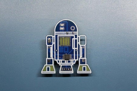

I’ve always loved art, especially painting. So when I started learning electronics, I was instantly intrigued by how makers were turning PCBs into visual canvases. Logos, illustrations, and patterns are all etched into the solder mask and silkscreen layers. That’s when I knew I had to try it myself.

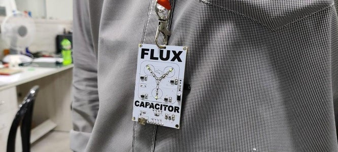

My journey into PCB art began with a Flux Capacitor board, where I used LEDs to recreate the iconic flux capacitor design from Back to the Future. That project gained attention on Hackaday and other maker platforms, and it sparked a whole series of creative builds.
Next came Pandacorn, which was a panda with a unicorn horn. I placed all the SMD components and LEDs on the bottom side of the board and designed the panda illustration on the top. The horn area had the solder mask removed from both layers, allowing light from the flipped LEDs to shine directly through the board. I first saw this clever trick in a Hackaday SAO badge, and it opened up a whole new way of thinking about PCB layering.
Since then, I’ve created multiple themed boards inspired by Halo, Attack on Titan, heart-shaped badge, R2-D2, and more. You can check them all out on my Instructables page.

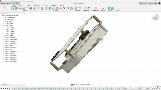

Before starting the PCB design, I first created a 3D model in Fusion 360.
For projects like this, a 3D Model is super crucial, as it allows you to finalize the size and placement of major components, which affects the PCB layout. Precise dimensions and positioning are essential when working with tight tolerances and layered boards.

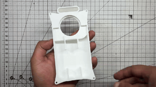

In this build, the speaker plays a central role. It not only needs to be supported securely within the enclosure but also positioned to enhance sound quality. That’s why designing the enclosure early was key; it helped shape both the mechanical and acoustic aspects of the project.

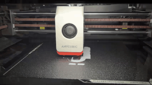

Once the model was complete, I created an enclosure that houses both the speaker and the lithium cell. The mesh file was exported and 3D printed using my new Anycubic Kobra S1 — giving the project a clean, custom-fitted shell that ties the whole build together.

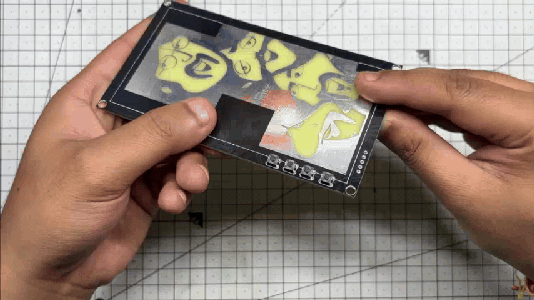

For the Front Art Layer, we took the image found on Pinterest, scaled it to match the PCB dimensions defined in the 3D model, and converted it from JPG to a monochrome BMP format. This allowed us to import it into the PCB CAD tool as a logo.
We applied copper etching to all black areas in the image, while the white regions were left as solder mask openings. The same solder mask openings were added to the bottom layer as well. The idea was to use the etched areas to block light and the solder mask openings to let the RGB glow pass through.

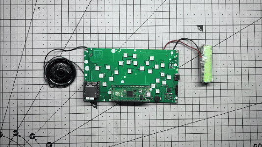

Step 6: MAIN BOARD ASSEMBLY PROCESS

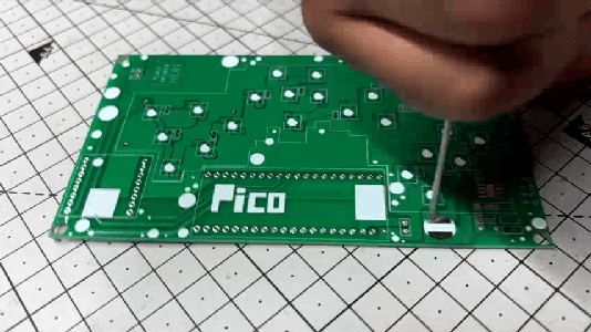

  1. We begin assembling the main board by applying solder paste to each SMD pad using a dispensing needle. For this build, we’re using 63/37 Sn/Pb solder paste, which has a melting point of around 200°C.

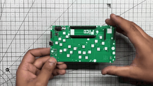

  2. Next comes the pick-and-place stage, where each surface-mount component, which includes RGB LEDs, the IP5306 power management IC, capacitors, and resistors are carefully positioned using ESD-safe tweezers.
  3. Once all components are in place, the PCB is transferred to a reflow hotplate. The board is heated from below until it reaches the solder paste’s melting temperature. At that point, the solder melts and solidifies, locking all SMD components securely in place.

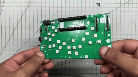

  4. With the surface-mount process complete, we move on to the through-hole components. Female header pins for the Raspberry Pi Pico and DFPlayer Mini, a USB Type-C port, male header pins, and an inductor are added from the top side of the board.
  5. The PCB is then flipped, and all through-hole pads are soldered manually using a soldering iron to ensure strong mechanical and electrical connections.
  6. Finally, the Raspberry Pi Pico and DFPlayer Mini are mounted onto their respective headers, marking the completion of the assembly process.

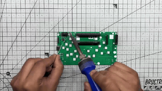

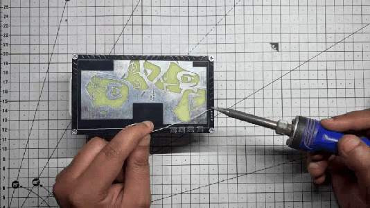

The front board contains four through-hole 4×4 tactile push buttons. Each button is placed carefully into its designated position on the PCB. Once aligned, the board is flipped over and all the pads are soldered securely, locking the buttons in place.

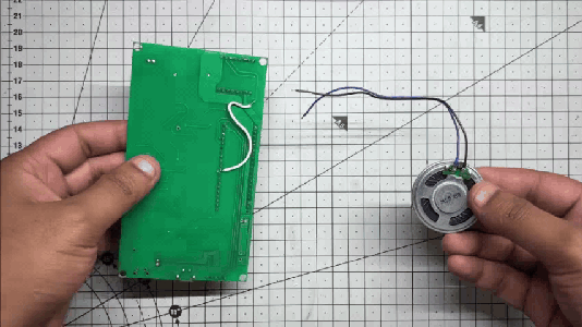

Step 9: SPEAKER ASSEMBLY
Next comes the speaker assembly process. It begins by soldering the speaker’s positive terminal to the Speaker 1 pin on the DFPlayer Mini, while the Speaker ground (GND) terminal is connected to the Speaker 2 terminal of DFplayer.
This simple wiring setup completes the audio path.

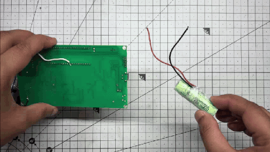

Step 10: POWER SOURCE
The original plan was to use a standard 18650 Li-ion cell but ended up using a 14500 lithium cell. It offers the same operating voltage of 3.7V but with a smaller form factor and approximately half the capacity — around 600mAh.
The positive and negative terminals of the 14500 cell were soldered directly to the board’s battery connector using a soldering iron, completing the power circuit.

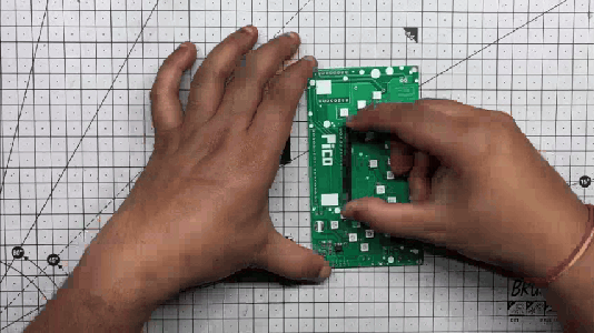

Step 12: FINAL ASSEMBLY

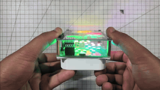

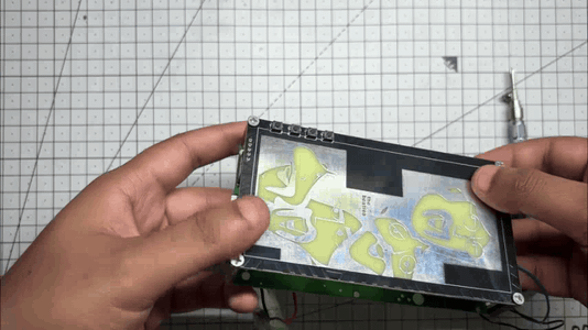

  1. To connect the main PCB with the front PCB, we use a custom-built CON5 header, a makeshift connector made by soldering a male header pin directly to a female header pin. This hybrid setup plugs into the male CON5 connector on the main board, creating a reliable link between the two PCBs.
  2. Next, we install four M2.5 PCB standoffs into the mounting holes of the front PCB. With the header connector and standoffs aligned, we carefully sandwich the front PCB onto the main board, locking the two layers together both electrically and mechanically.

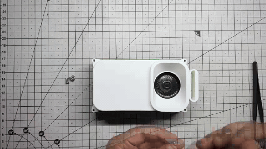

  3. We then move to the enclosure. A 3D-printed shell houses the speaker and lithium cell, which are placed securely in their designated slots. The entire enclosure assembly is positioned behind the main PCB, and four M2. 5 screws are used to fasten everything together—completing the build.
  4. At this point, the device is fully assembled.

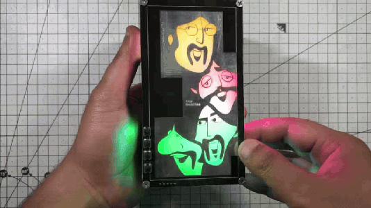

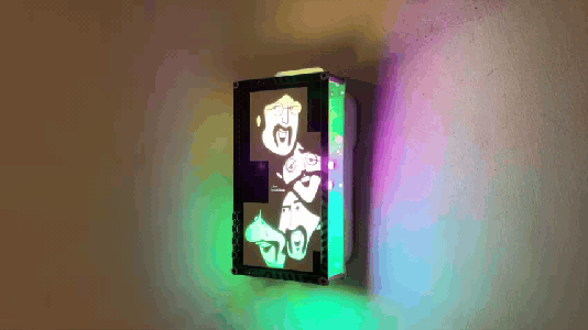

Step 13: RESULT
Here’s the end result of this simple yet fun build-a Beatles-themed art-light music player that’s hard to categorize. It plays a selection of Beatles songs stored on an onboard SD card and features a custom front panel with cartoon-style illustrations of the four original Beatles members.
The panel glows in four distinct colors, each mapped to a zone of RGB LEDs beneath the artwork, giving the device a vibrant, aesthetic feel. It’s designed to rest on my desk, right beside my monitor, but I also added a hook so it can hang on a wall using a nail.
It’s not just a music player. Not just a lamp.
It’s a fusion of sound, light, and illustration a personal tribute built from electronics combined with ART.
