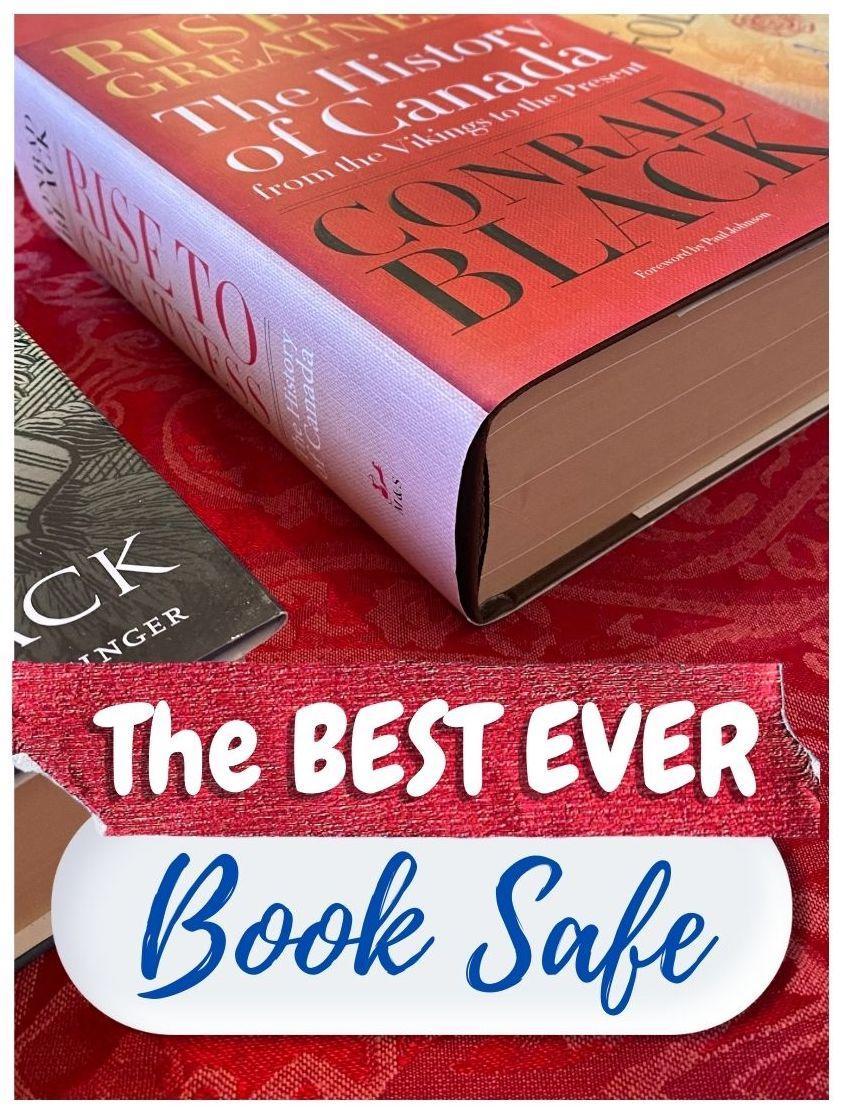

Introduction: The Best Ever Book Safe
I have never made a book safe before, so decided to give it a try. This one has three compartments (with a magnetic key), and was fun to make!

I chose the biggest, thickest, hardcover book I could find in my house (3" thick). If your book isn't thick enough, you might be better off making two compartments instead of three.
