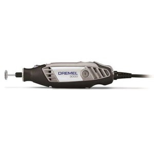

  1. The Rotary Tool – https://amzn.to/3H1YnQI | https://ebay.to/4k2GGz9

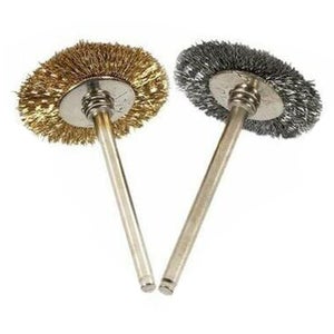

Step 1:
Steel vs. Brass
  1. Steel wire brushes: Tough and aggressive, great for removing oxidation and surface imperfections. But be careful—pressing too hard can damage fine details.
  2. Brass wire brushes: Softer and more delicate, perfect for cleaning without scratching or removing too much patina.
Tips:
  1. Steel brushes strip patina quickly.
  2. Brass brushes preserve patina while cleaning.
  3. Use water with dish soap to prevent brass residue from staining copper.
  4. Always wear eye protection and gloves—those tiny bristles can fly.

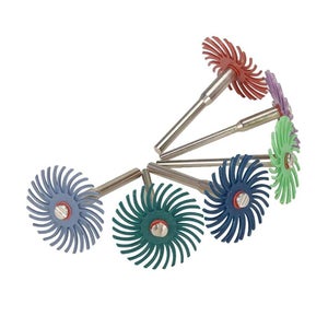

2. Bristle Brush Wheels
These flexible plastic wheels come in a wide range of grits (from 80 to 12,000) and are excellent for every stage of polishing.
  1. Coarse grits like 400–600 remove oxidation and patina.
  2. Fine grits like 1000–12000 refine the surface and bring out a mirror shine.
  3. Can be used to shine patinated areas without removing the patina color.
  4. Stack them to cover larger surfaces quickly.
These are my favorite wheels for polishing copper—delicate, precise, and highly versatile.

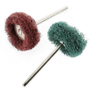

4. Scotch-Brite Wheels
Made from non-woven abrasive material, these wheels are perfect for creating a uniform satin finish.
  1. Grades range from 120 to 600.
  2. Don’t create a mirror shine, but leave a clean, even texture.
  3. Excellent for prepping metal before electroforming.
  4. The 600 grit is great for polishing graphite paint without damaging it.
These wheels are very gentle on fine details and ideal for surface prep or satin finishes.

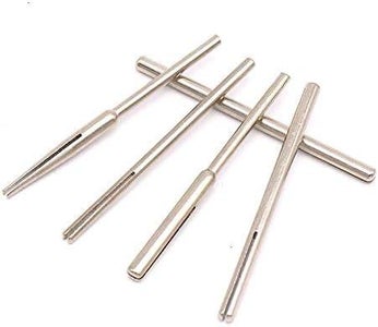

6. Sandpaper Split Mandrel
A simple shaft that holds rolled-up sandpaper or brightening cloths.
  1. Fully customizable: use any grit or cloth you want.
  2. Inexpensive and effective.
  3. Great for mild polishing or oxidation removal.

While the rotary tool isn’t always essential—especially if your electroforming bath is perfectly balanced—it’s an incredibly useful time-saver. Whether you're restoring shine, enhancing contrast, or prepping a piece for electroforming, the right wheel can help you get the job done faster and more effectively.
