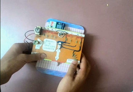

A 4-bit Binary to Grey Code Convertor is a digital electronics device. It is used for conversion of n- bit Binary Code into Grey Code. A sophisticated version is that which shows the code conversion with the help of LEDs which glows. Apart from this, a small modification has been done thereby eliminating redundancy of changing wires'(potential 0 & 1 ) manually . The motive behind this project is to bring improvement, and efficiency, and create an impact by tackling existing problems.
Basically we need digital electronics components. All of them will be soldered on a Zero PCB. Also, I have attached a table enlisting the approximate price of individual components in the Indian currency

Step 1: Circuit Diagram/ Schematics of the Device.
In this section, a circuit diagram is shown. Those who want to replicate the project may closely look onto the circuit diagram for better understanding. One thing which distinguishes this code Convertor from ordinary ones is that I have considered adding 4 identical resistors of 1kilo Ohms each in between adjacent EX-OR ICs.
Advantages of the modification:-
1) It will eliminate the need of changing wires frequently for describing different combinations.
2) It will prevent the soldered parts from getting distorted or broken especially the wires.

This particular device can display upto 16 unique combinations. Needless to mention, EX-OR IC is the brain behind the working of this model .
