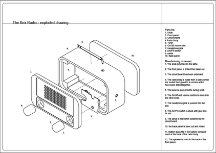

Step 2: Exploded View
Here is an Exploded view to help you see how all the parts will fit together. I have included a PDF because its quite difficult to read.

I created an autocad drawing which i then imported to illustrator i then cut the holes 26mm all the way through and a 52mm hole around 11mm from the back leaving 1mm wood for the laser cutter to cut through. Then i set up the laser cutter and etched the detail and cut the speaker grill out afterwards i sanded it.
