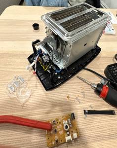

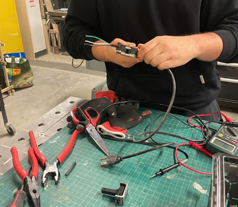

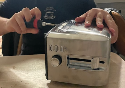

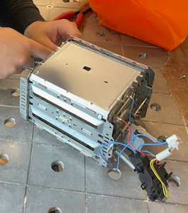

Step 1: Taking Apart the Toaster

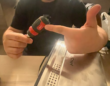

  1. A Milwaukee screwdriver was used to release the security screws and release the outer shell from the base.
  2. Two clips at the bottom of the control board were released, seperating the control board from the electro magnet and relay.
  3. All electronic components using side cutters, leaving in only the nichrome heating elements and their respective wires.

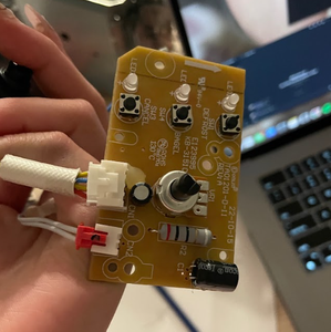

Step 2: Learning About Its Parts and Functions
How the Original Toaster Functions:
1. Plugging in the toaster supplies power to the circuit.
2. Twist knob/potentiometer to set the timer for your toaster. This changes the resistance on the potentiometer to determine the rate of energy filling the capacitor.
3. Pushing the lever down closes the circuit, activating the electromagnet, nichrome wires (heating element), and the timer system.
4. Energy flows to the capacitor through the variable resistor, with its resistance determined by the potentiometer.
5. Once the capacitor is full, the microcontroller deactivates the electromagnet cutting power to the circuit and popping the toast.
Bagel button:
1. Turn on the LED next to the button.
2. Changes the state of the relay to turn off the inner nichrome wires (when pressed only the outer panels will heat up, toasting only the inside of the bagel).
Defrost button:
1. Turns on the LED next to the button.
2. Adds a set amount of time to the microcontroller, extending the heating time.
3. After the extended time is up, the capacitor timer system runs as it usually would.
Cancel button:
1. Bypasses the resistor and fills up capacitor immediately, deactivating the electromagnet.
2. The lever is released, turning the heating element off.

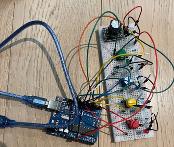

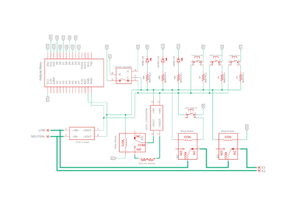

Step 3: Assemble the Circuit
The circuit was built on a breadboard to allow fast prototyping throught our iteration proccess. There are three corresponding LEDs for each button input; one for bagel, one for defrost and one for cancel. While testing we used three Arduino buttons on the breadboard to mirror the toaster buttons. The buttons are pulled low and connected to the arduino pins D2, D4 and D7 with the coresponding LEDs connected to D9, D10, D11.
Two extra LEDs were added as indicators to simulate the electromagnet and heating relays on the toaster.
Step 4: Connect the Breadboard and Test the Code
Wrote a code to function as intended:
The code first sets a correct combination in an array to crack open the locker toaster (3 CW, 3CCW, 5CW). Then, it sets the total of these values as the correct rotary encoder read to open the heating element (3 + (-3) + 5 = 5). The defrost button is coded as a hint button, to read the absolute values of the array and flash the bagel and cancel LEDs to hint at how many times to turn CW and CCW. A popToast function turns on all the LEDs for 5 seconds, before turning off the electromagnet and releasing the lever and mechanism, popping the toast. This function is called whenever a button other than defrost is pressed, or when the lever is pressed following an incorrect encoder dial. The cookToast function flashes the LEDs rapidly to show excitement following a correct combination, and turns on the heating element for the set cooking time (60 seconds) before popping the toast.
Tested the code on a breadboard before transferring it to the toaster.

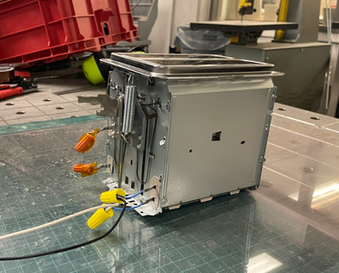

Step 5: Fabrication and Pre-assembly

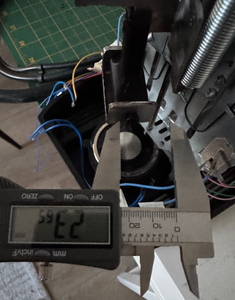

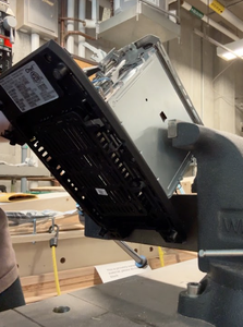

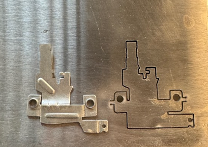

A stronger spring and electromagnet were added to enable the toaster to launch toast into the air. The original carriage bracket was not strong enough for this change so it was replaced with a custom fabricated 2mm steel plate. The steel plate was cut using a waterjet and bent into place using a break.
The base of the toaster was designed and 3d printed in ABS to fit our electronics and provide adequate mounting points for the toaster components.

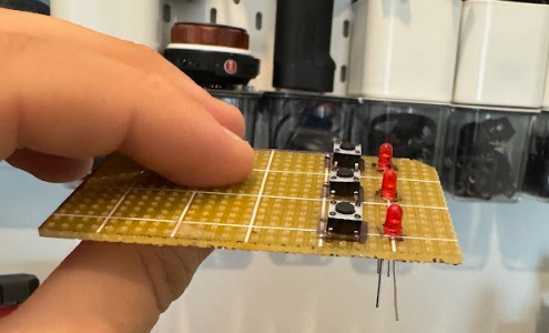

The buttons and leds were soldered onto a prototyping board which was sized to fit in the original PCBs location. The rest of the support electronics were mounted in the base of the toaster.

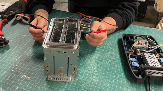

Step 6: Test Nichrome Wire Heating Element
The Nichrome wires were toned for contenuity and resistance. Once the two loops of coils were identified they were tested, connecting 125v AC for one minute intervals while monitoring current and voltage.
After the tests were complete the wires were marked and connected to the high voltage relays.
All tests were completed in an open area with the propper PPE.

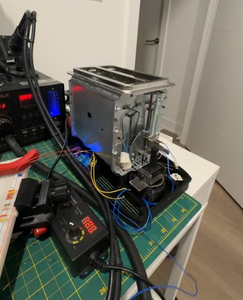

Step 7: Complete Assembly of the Toaster
The toaster assembly was completed by attaching the 3D-printed base and outer stainless steel case to the toaster using the original security screws. With everything now assembled, the Crumbination Lock™ is ready to use. Get ready to prank everyone with flying toast!
