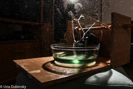

Introduction: The Bubble Maker Machine
The idea i got from a lasercut plastic similar machine i've seen the the Geek Picnic festival.
Since i dont have access to a laser cutter i have desided to made it out of wood cut with simple tools like a jigsaw and a dreamel.
This is kinda an upgrade for me since this is the first time i made a fisical machine wich does something in the fisical world and the first time i make a machine wich has moving parts and joints.
Watch it works :

Step 2: Structure
Build the structure, install the servo and connect the shaft through the shaft hole to the servo.
Then connect the popsicle sticks as arm on the shaft and connect the string tto the arm.
Configrue it in a shape of a circle or a squere.
