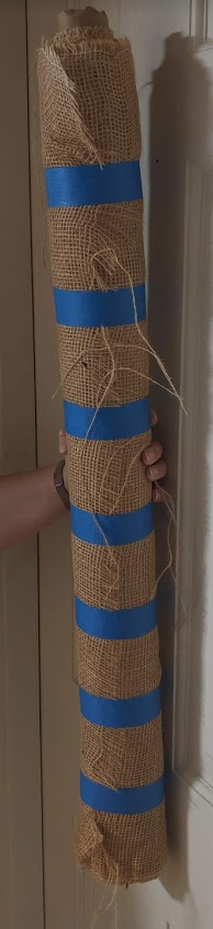

Tip 2 years ago on Step 5
Take your 36 in by 24 ft long garden center roll and tape in 4.5 in sections. this makes for 8 exact sections. Each leg gets one length. $11 at local box store.
Use a miter saw but only cut down to the center cardboard tube. Turn about 3x to get the whole thing cut. then repeat 7x more. I struggled with how loose to make it but I only had to cut one section off when the saw really hated me. You will end up with loose burlap fuzz around the saw.
