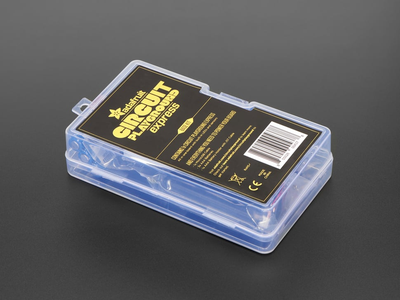

- Adafruit Circuit Playground Express Basekit - https://www.adafruit.com/product/3517
