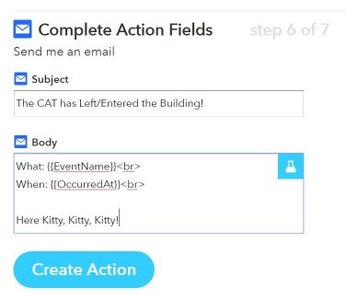

11. Type “email” into the Search Channels box. You could change this to do other things, like send SMS messages, etc. But let’s stick to email. You can always edit later.

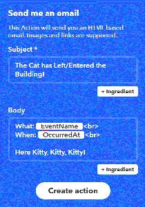

14. For Choose an Action, click the big gray box with “Send me an email”.
15. Click the big blue box with “Send me an email”.
16. You can edit the text or just leave it as is. Some of the fields aren’t used, but they just show up blank in your email.
17. Click Create Action. You will see a screen that just describes what this recipe will do. You can edit the Recipe Title, or just leave as is. Click FINISH.
18. NOTE that it uses the email address you entered when you signed up for IFTTT.
19. You now have an IFTTT Recipe.

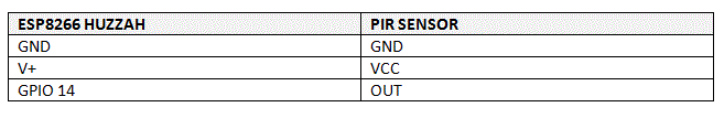

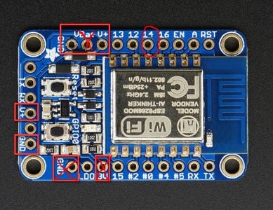

Step 4: Hardware - PIR
1. Temporarily unplug the FTDI/USB cable from the PC to power off the ESP8266.
2. Wire the PIR sensor as follows. Note that the PIR is powered by 5V, but its I/O line is 3.3v which makes it directly compatible with the ESP8266’s 3.3v GPIO pins.
(See Pinout diagram)
3. With the PIR now wired in, reconnect the FTDI/USB cable to the PC.
4. Again, start the Serial Monitor from the Arduino IDE.
5. Reset the ESP8266 and you should see the LED blink 4 times and the IP address displayed again.
6. If you move in front of the PIR, the Serial Monitor should register the event and send off to IFTTT. If IFTT trigger is successful, you should see a 200 OK HTTP response message and text and receive an email.

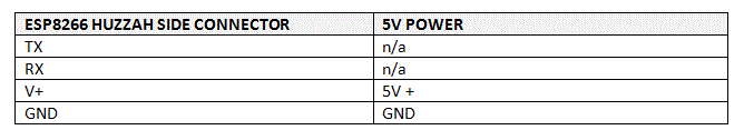

Step 5: Hardware - Power

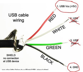

1. Since the Adafruit HUZZAH ESP8266 supports operating on 5V, a 5V USB battery or USB power supply can be used. Since we tied the PIR sensor directly to one of the V+ pins, the battery or power supply is going to have to connect to the V+ and GND that the FTDI/USB cable connected to. So if you need to reprogram the ESP8266, you will need to disconnect these.
(See Cable Pinout diagrams)
You may need to build a USB-to-ESP cable by taking an unused USB cable and cutting it as shown in the cable diagram above.

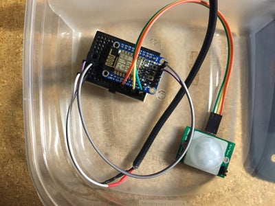

2. Once ready, plug in the USB connector to your power supply or battery.
3. After a few seconds, you should see the red LED blink four times to indicate it connected to your WiFi.
4. Do some motion and after a minute or so, an email should arrive!
Place everything into a box. The PIR sensor will work thru clear plastic, but is more sensitive if mounted outside. Put the box near the cat door (or anywhere you want to detect motion) and you are ready to go.
