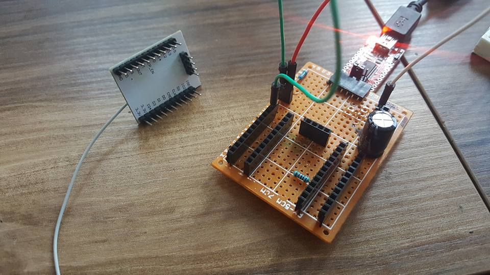

Hi folks, now I'll teach you how to make your programmer to the ESP-01 and ESP-201, (perhaps serve with other models) using an Arduino UNO, a few cables and optionally a button and a slide switch, in my case I use them because I had available, with this programmer able to upload the Arduino sketches and any other firmware (AT, LUA, Espruino, etc).
Step 1: Okay, Let's Start, First Do the Following Circuit.
Optionally if necessary can place a 100n capacitor between Vcc and GND and if you're a fan of security, you can put a divider or Logic Level Converter voltage between RX and TX.
Step 2: Step to Flash the ESP-01 and Esp-201
1.- Connect the Arduino/Genuino UNO.
2.- Put the ESP-01 in Flash mode, set the slide switch to GND.
3.- Push the Button reset.
4.-And open the app for Flash, that you like.
Note.- I test with:
a.- Flash tool 2.4 -Link-
b.- ESP8266 Flasher -Link-
c.- Arduino IDE -Link-
That is all!!!
Enjoy!!

only one minor err I spot, on the fritzing drawing.. note you have a wire going from vcc (the 3.3V power rail) to the CH_PD pin, and the reset switch, and the other side of the switch to GND (causing a dead short when pressed, to the 3.3V supply.) I think you meant to create a red wire from the CH_PD to VCC, and only a single wire from the open end of the switch, to RST. Otherwise, that's going to be brutal on the 3.3V regulator

The changes is ready!!
0
Hulkco
Hulkco
5 years ago
Thanks, I will make the correction as soon as possible.
