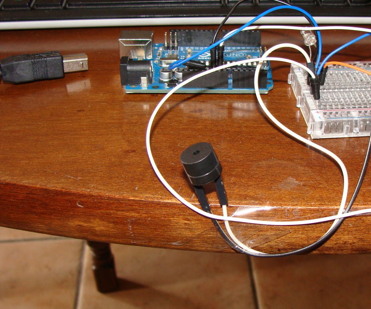

A few days before I started playing around with my Arduino again after almost a year of it being untouched. Having nothing to do I found a little buzzer in my huge pit of electronic components. I connected it and started coding stuff to it. About an hour later I had Jingle Bells playing on it. I found that fun and started thinking what I could do with this useless piece of Xmass code. So that's was when the Christmass Box idea emerged from the depths of my head. So what the crap is this ? Well it's a box. It consists of an Arduino Mega 2560 -Uno works too but mine broke down :( -, a Button, a speaker/buzzer and last but not least the Adafruit Thermal printer which I used just cause I had it lying around.
