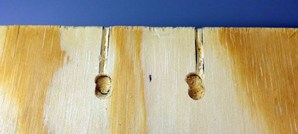

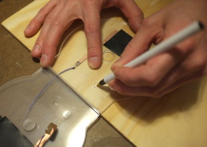

To make the clamshell stompbox "stomp proof", I wanted to lay it over a flat surface with channels cut for the wires to run through.
I grabbed a piece of scrap plywood, and enlisted a little help on the woodworking. Here's what we did:
First Dan marked the midpoint of the wood along one edge, and lined the midpoint of the clamshell up with it. (This one already had a handy dimple at the midpoint.) He opened the clamshell, so the side with the two holes in it was against the wood, then marked the holes in the wood.
Step 5:
With a square rule, he drew parallel lines from the holes to the edge of the wood. The lines indicate "channels", just wide enough for the wire to sit in.

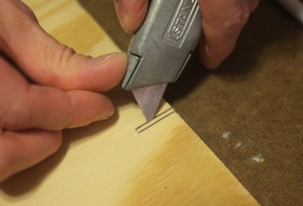

Step 6: Cutting the Board
Next he used a utility knife to cut along each line, cutting a little deeper than the wire's thickness, so the wire would lay below the surface of the wood. (It's not visible in the photo, but the board is clamped to the table - otherwise it slides around and is impossible to cut.)
Once the outline was cut, he used the knife to cut under the wood, and was able to lift each piece out.
We put the clamshell in, and tested the fit--  a little too shallow for the wire. So he repeated the cutting, until it was deep enough.

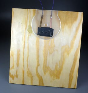

Once that was finished, I laid the clamshell on top. The wires fit, but I thought the solder points could use a little more room. So I drilled a few holes around the end of the channels, for the solder points to fit in.
Step 8: Finishing the Board
Next came the hot glue. I put a blob over each solder point, for added protection. Then I spread glue on the back (the side without the holes). I lined up the wires in the channels, and glued the whole thing to the board.
The end result was nicely functional and flat. I only put a little glue on it because I wanted to be able to remove it to show my students. However... I suggest you use a liberal amount, especially around the wire channels so they don't slide out.
