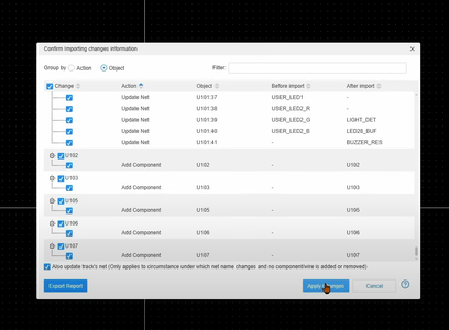

Step 11: Check Design and Import to PCB
Run a DRC check to ensure no schematic errors. Then, import changes to the PCB editor. Keep microcontroller placement and delete other parts. Unlock layers and remove old enclosure models. Proceed with updated schematic content.
