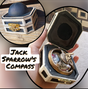

In this Instructable I'll show you how I made Jack Sparrow's unique compass from Pirates of the Caribbean.

Step 1: Build the Box
To make the basic box shape, begin with two 1/4" thick pieces of wood. My squares were 3x3", and of course you can adjust accordingly.
Next, cut the four corners of each square, creating an uneven octagon. This will be the top and bottom of the compass. If you are like me and get easily confused and/or flustered, it might be to your advantage to label them 'Top' and 'Bottom'.
For the sides, you want to make sure that the bottom half of the compass is deeper than the top half. So, the bottom's sides need to be taller. Now, exact measurements are really not my thing; in fact, they make me even more confused. So I just eyeball it and call it good for me, but it does make it slightly inconvenient when writing directions. So for your sake and the sake of my sanity, I'm going to round up and say the bottom's sides are 1" tall, and the top's sides are 3/4" tall. Glue the sides onto the base using a strong wood glue, clamp it tight, and let it dry completely.

When these have been baked and cooled, paint them black. Then dry brush a good coat of coppery-gold. Dry-brushing is when you get a small amount of paint on a dry paintbrush, then wipe most of it off on a paper towel. Then brush the remaining paint onto your surface, and voila. This brings out the texture on whatever surface you're painting, and in this case, makes the compass look like weathered metal. I also painted the ring on the platform with this color to match.
Step 8: Paint the Compass
For the compass box, paint the not-raised parts in a dark navy blue color. Then paint the raised bits in white.
To make the compass look less new and more like its been carried all over the world and thrown into the sea a few times, mix up a dark brown wash. A wash is paint mixed with a bit of water. When brushed over the surface, it will seep into the cracks and recesses. Then dab it gently with a paper towel to get off the excess. The result is the slightly dirty and worn look that we're going for.
Now, glue the sundial into place.
Step 9: Finishing Touches
Now, it's time to add the hinges and clasp. For the hinges in the back, you may need to carefully remove some of the white raised bits to screw them on properly. When the hinges are on, do the same to the front, adding the clasp.
Finally, cut a piece of black or brown leather to fit nicely into the lid of the box. Cut a hole in the center corresponding with the dome, and glue it in place.
Step 10: DONE!
