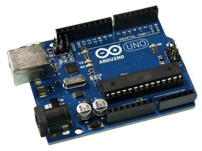

1. An Arduino Board( I used an Arduino UNO)

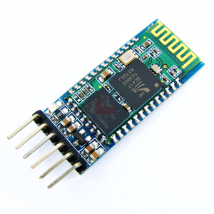

2. A hc-05 bluetooth module

Relay connection: Connect the 5v input of 8 relays to the digital pins 0,1,4,5,6,7,8 and 9 of the UNO board and short the gnd pins and connect them to gnd pin of the board. Give a common input voltage to the relays of 230V 50Hz AC. The output pins of the relays should be connected to the wire from electrical appliances connected to the switches in the switch board. Connect the output pins of relay 0 and 1 to the electrical lamps, 4 and 5 to the fans, 6 to the A.C, 7 to the water pump, 8 to the TV, and 9 to the kitchen chimney.
Bluetooth connection: Connect the Vcc and Gnd of the hc-05 to 5V and Gnd of the UNO board. Now connect the Tx and Rx of the module to digital pins 2 and 3.
Sensor connections: Connect the LDR and FSR to the 5V and then a 1K ohm resistor in series with each one of them, connected to the Gnd. Wires should be connected to the terminal of LDR/FSR with resistor. Wire coming from LDR resistor terminal should go to analog pin A0 and that coming from FSR resistor terminal should go to analog pin A2.
The circuit diagram is given. Including this the UNO board requires to be power using the usb cable or 2.1 channel.
