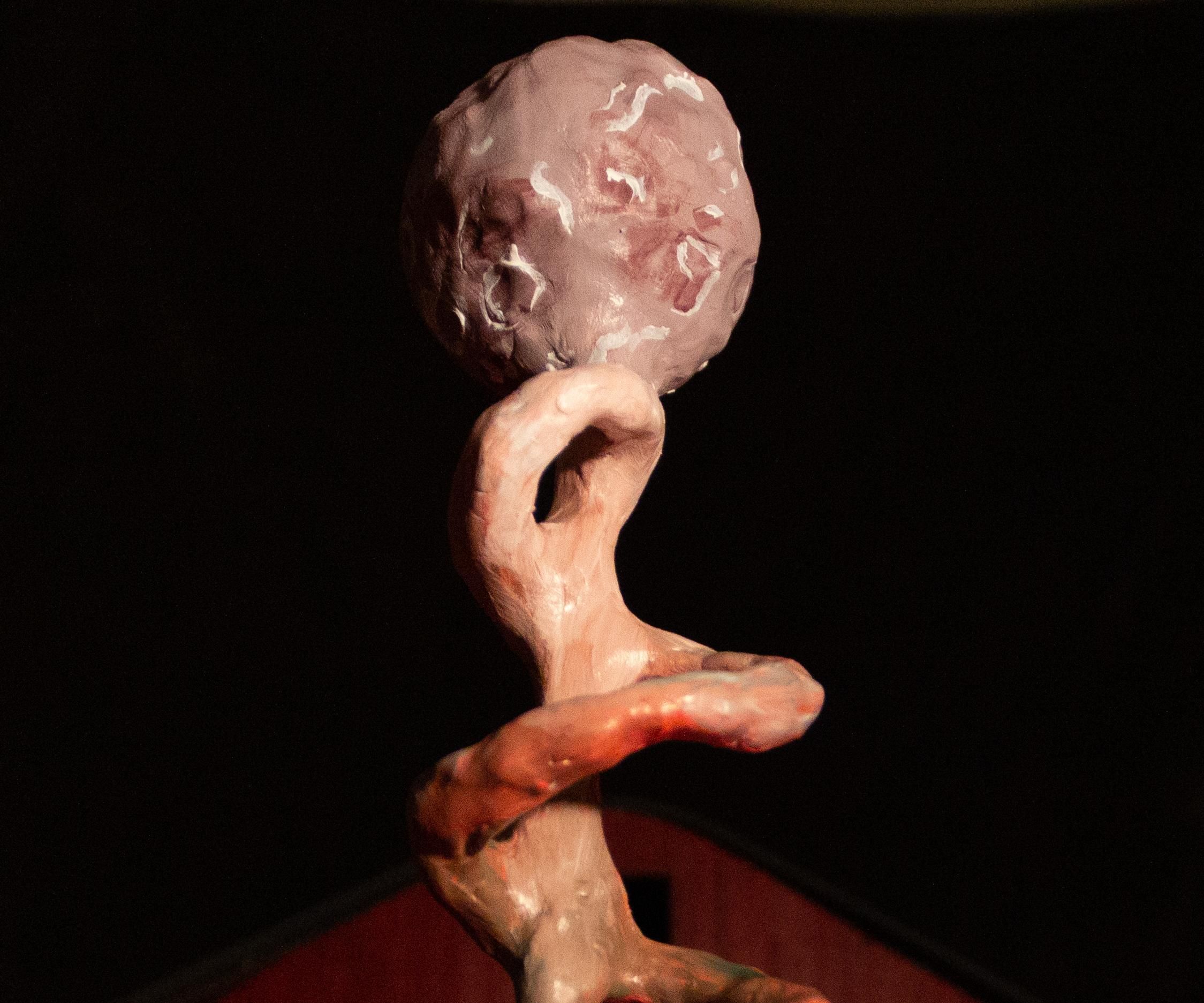

Step 7: Step 7: Future Work
The Creative Cap is an ongoing project. There is also a brainstem made of natural wood in development and a variety of other wearable circuits being created. My version of the Creative Cap has transitioned into being called "My Head." It would be fantastic to see a library of the Instructable community's Creative Caps!
