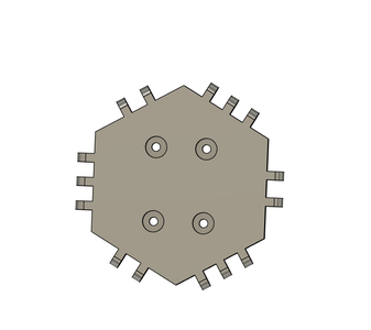

Hexagons, plus an alternating axle system, make up the bases. A simple, and hopefully elegant, place to build from.

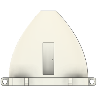

Then the domes, for the reasons mentioned in the introduction, are revolved and detail is added.
Then, after far too much overthinking, windows with rounded corners were put in.

My first draft of the domes had a square base, but then I realized hexagons had more possibilities for expansions. The first design had no electrical or water systems included; it was mostly just a sounding board to figure out what design ended up working best.
First, I revolved a curve around a center point to create the initial dome part. I found this was the simplest way to design the dome, as opposed to lofting two points. This allows more control over the angle and thickness of the dome, and makes it easy to revise the design.
The first base was a crude square with some basic hinges. This would allow the domes to be arranged in grids, which, in hindsight, makes some sense, but I liked the further modularity of hexagons for the second design.

Now that I had the rough design figured out, I was able to begin a final design. Things got complicated quick.
In short(ish) Here are all of the things included in the final design.
  1. two floors
  2. a basic bedroom/kitchen layout
  3. water routing holes
  4. electrical routing
  5. Model split into two part IF two floors are needed
  6. hexagon base
  7. rounded hinges
  8. holes for ground anchors or floats in special bases
  9. Windows
  10. discreet vent holes

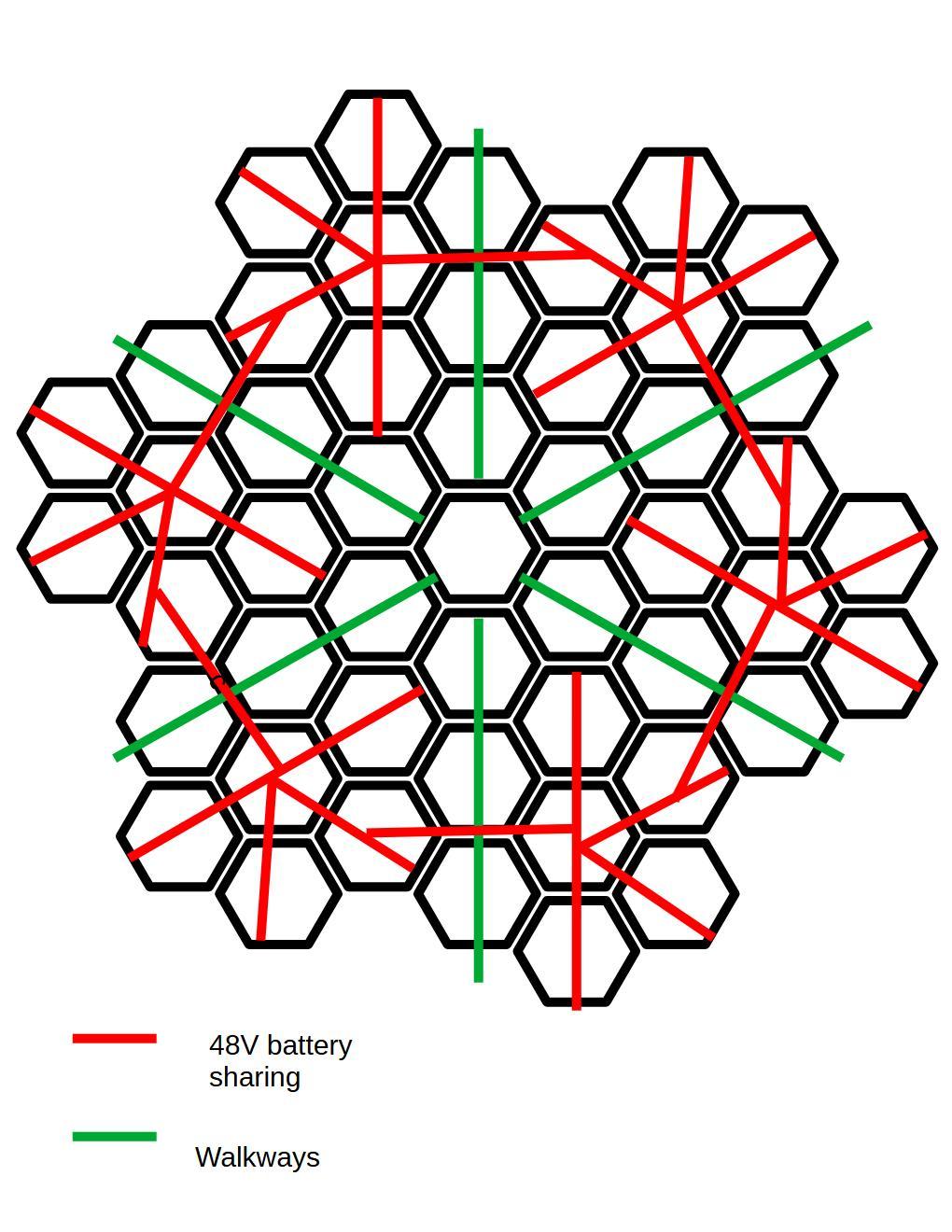

Step 4: Electrical Systems Overview
Each dome contains a 48V DC battery that is connected in parallel to identical domes and also connected to an inverter to convert into standard 120V AC "wall power" to power appliances, electronics, etc. While AC power is safer to transfer, it is a big loss of efficiency to have to charge each of the batteries with other batteries.
The battery is to ensure redundancy and allow power to be as simple, while still being as modular as possible.
For example, if a tornado comes through and damages 7 housing domes, the remaining 8 in a cluster would still be able to function at full capacity without any sort of power outage. All of the wires going between domes would have fuses to prevent an electrical catastrophe.
Power would hopefully be provided by off-grid sources of electricity based on the area. (solar, wind, geothermal, tidal, etc.)

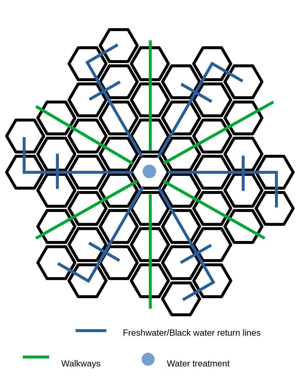

Step 5: Freshwater and Blackwater Systems Overview
Plumbing is a realm I am not familiar with in the least, but it is very much needed. There are three ways to go about this:
A. Full Blackwater/Freshwater off-grid
The domes are too compact to hold a water heater and operate efficiently, so one dome in a cluster would have to serve as a desalination/ water heating station. This is less redundant, yes, but an entire enclosed water heating system in each would take up far too much space. lines for each would all return to wherever the station would be placed. See the above diagram for one possible solution.
B. Compost toilet and freshwater tank
This is the simplest solution, and is by far the cheapest. A compost toilet can keep the smell down and is portable, but needs often maintenance. The potable water tank could wash dishes, provide freshwater, and give (limited) water to wash in.
C. City water
If the domes are constructed or placed in an area where residential water can be put, that is an easy solution. Residential standards might take up a little more space than a compost toilet, but are familiar to plumbers and would be a good standardized solution.
