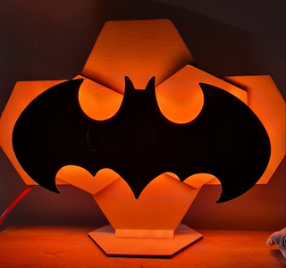

Step 1: 3d Printing
To start everything let 3d print batinlnlay and the D1 mini box.

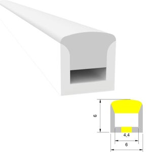

Step 2: Assembly the LED Strip and Defuser
  • measure your defuser length on the 3D-printed inlay
  • insert your led strip in the defuser
  • solder wires to control the led strip
  • glue your defuser with the LEDs to the inlay

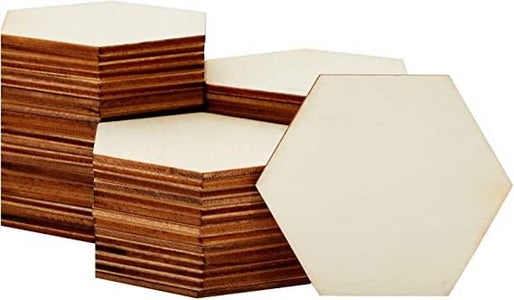

Step 3: Assemble the Back Plate
Currently, I am using hexagon cutouts so the shape of the backplate is entirely up to us.
Step 4: Flash the Controller and Make the Connections
We can flash our controller by following the instructions provided in https://install.wled.me/
Solder the wires connecting the controller and LEDs.
Month the case for D1 mini to the backplate.
Step 5: Configuration
In my case, I wanted to gradually reduce the intensity of the lights during the night.
To tackle this I used a copple of presets with reduced intensity in conjunction with triggers on time.
Step 6: Final Words
Quick and easy project that I made with the kids.
Other ideas that can be used here are using other inlays with different characters maybe Sonic can look cool in this setup.
