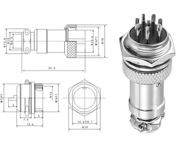

  1. 6 circular 8-pin ‘aviation grade’ plugs and sockets, such as
https://www.amazon.de/dp/B07NYYKQVZ

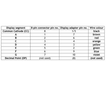

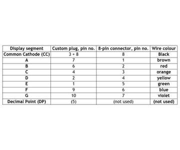

The small, original LED displays will not be used. Instead, I provided custom-made adapter plugs made from small pieces of matrix board (some of them even recycled) and two 5-pin male pin headers in such a way that the plugs can be inserted in the display sockets. For dimensions see the 4th picture above.
Solder thin stranded wires to the 8-pin connectors that will be connected to the custom plugs later. I used wire colours adhering to the standard resistor colour code (with the exception of the black CC wire). The seven display segments have standard designators ‘A’ to ‘G’, and ‘DP’ for the decimal point, see the drawing and the wiring table above. Drop the six connectors into their holes in the top cover so that the wires face downwards and tighten their nuts. Before doing that I temporarily covered the scratch-sensitive upper face of the aluminium sheet with painter's tape in order to protect the surface from damage. Then connect the wires to the custom plugs that are already plugged-in in place of the small LED displays, again according to the wiring table above.
I doubt that the circular, 8-pin connectors are indeed approved by aircraft manufacturers, although their product description says ‘aviation grade’ :-) – but they are a bargain and more or less fit for our purpose. For our prototype, they are ok, but in series production, I might select a more sturdy solution, since unfortunately the mechanical fit is a bit wobbly even after tightening the coupling ring.
Guess what happened when I tested the finished base unit together with the first pluggable display unit. Right: There was absolutely nothing, not a single display segment was illuminated. Some diagnostics time later, the culprit was found. My wiring was almost ok, but I had missed the fact that the original, small displays have an internal connection between pins #3 and #8, i.e., they have two common-cathode pins. The clock PCB, however, only feeds supply voltage to pin #3. My black wire however went to pin #8 of the custom plug – which means that this supply voltage did not reach pin #8 of the circular 8-pin connector. The easiest remedy I could think of was connecting pins #3 and #8 on the clock PCB’s solder side, using some short, insulated wire - see the next-to-last picture above; after that, the display illuminated nicely.
The last picture is a bottom view of the completed and wired base.

Step 5: The Display Stand Wiring
Before purchasing wires I checked whether eight of them might be threaded together through the 4 mm bore of the aluminium tubes. I found some insulated wire with a diameter of 1.1 mm, and the easiest way to check this was by making a quick drawing, see the 1st picture above.
The wiring itself requires some patience. You need six times eight wires, that is, forty-eight in total, each of which having two ends, that is, ninety-six ends in total (in fact, it is the same number of wires and wire ends you already used for the connection between the clock PCB and the connectors in the base. These wires should be about 35 cm long. Strip and tin one end of each wire and solder them to the black contact pieces. In the picture above you can see the tiny pin numbers on the solder-lug end of the connector. The other end of the wires will be soldered later; use wire colours adhering to the standard resistor colour code (with the exception of the black CC wire). Refer to the wiring table above.
Inserting the wires into the small tubes is a bit tricky. It gets easier when the inside of the tube end is smoothed with a countersink or a triangular scraper. The wires need then to be exactly in parallel. If they are crossed or twisted, they cannot be pulled through the tube without being damaged. I made some templates to keep them in parallel while threading them (see PDF file below). Print the template on plain paper and glue them to a bit of not too heavy cardboard with a glue stick. I used a scrap cardboard piece from one of my favourite yoghurt containers :-) I had no colour printer available, so I coloured the templates the cheap way, using felt-tip pens according to the picture above. Punch the eight holes of each template with an awl. You can now thread the wires through these templates, matching the colours; start with the black center wire. Cut the wires then to identical length, strip them, twist the eight ends together and solder them. Connect a 50 cm length of sturdy scrap wire. Slide the template from the connector end to the other end and carefully pull the wires through the tube, starting at the end with the connector shell. Once the wires are threaded, you can tear up the template, taking care to not damage any of the wires. Insert the black contact pieces into the connector shells and fix them with the tiny screws. Cut the twisted ends of the eight wires off and strip/tin them once more.
When using the tripod and any optional decorative elements, thread the wires protruding from the tube, then the tube itself, through the tripod adapter first, then through the other optional decoration(s), and then through the 6 mm hole in the display adapter assembly. Slide one more slot nut into the profile, insert an M4 set screw and guide this screw through the profile’s lateral hole. You can now fix the display adapter assembly on the aluminium tube in such a way that the display faces forward once the completed display stand is connected to the base. Tighten the set screw with moderate force in order to not distort the tube too much.
Do not shorten the protruding wire ends. In case something might go wrong you will be glad to have some extra length. Strip and tin them again and solder them to the display adapter PCBs, again according to the wiring table above. You can now bend them to loops and hide them inside the slots to the aluminium profile using some adhesive tape.
