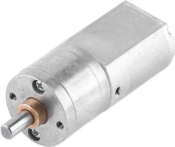

https://www.amazon.fr/Electric-Motors-Torque-Reducer-Central/dp/B0B15JP8DV/ref=sr_1_10?__mk_fr_FR=ÅMÅŽÕÑ&crid=25M3QCNVP0HJ3&keywords=12v+motor&qid=1704639737&sprefix=12v+mo%2Caps%2C462&sr=8-10

The assembly cam next once all the pieces were printed, I proceeded to clipping the pistons to the rods and the rods to the crankshaft before screwing the crankshaft claps to the block. I then generously applied some WD40 to minimise friction and make the load lighter on the 12v motor. The entire head assembly was complicated due to the small valves, valve caps and springs. All the gears came next and then timing belts.
