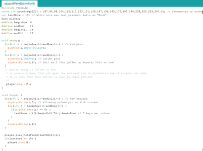

Code
The code is mostly for matrixing the keys, which will be explained more in step 2, aside from that it has an array of frequencies that correspond to pitches and when it knows which key on the keyboard has been pressed it calls the tone library to play that note on pin 5.

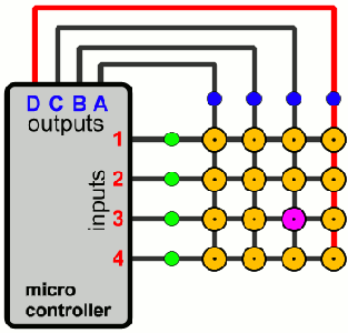

I used a keyboard from a salvaged toy keyboard but I know you probably won't have the same one when you're making this, this is how to use any arbitrary key matrix. The way a keyboard matrix works is by having separate rows and columns, the columns (or rows for that matter) source current and if the switch is pressed down then current can pass through and that can be detected. This is shown in the GIF here, the letters are sourcing current while the numbers are checking if their input is high and thus if the switch is pressed down. These are steps I took to decode my personal keyboard
Key Matrix GIF by Oli Glaser on Stack Exchange - Link (CC BY-SA 3.0)

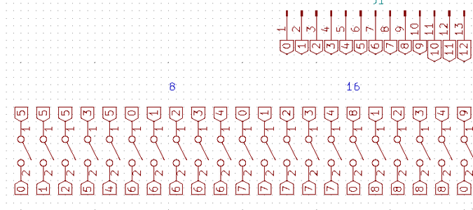

Step 2.1 - Isolate the PCB
If there are screws on the key-bed then remove them and remove the membrane on top of the PCB
Step 2.2 - Find Columns and Rows
In my keyboard's case there were 5 rows per column, sopins 0-4 (when I talk about the pins here I mean the connections on the keyboard PCB) were rows and on the schematic you can see a pattern where you'll have one pin on 5 keys (the first 5 keys are all connected to pin 5 for example) and the other side of those keys goes from 0-4
Step 2.3 - Change code for your key matrix
Now that you have your rows and columns, connect them to your Arduino! It doesn't matter where as long as all the rows come one after the other and the columns come one after the other. If you happen to be using the same keyboard matrix as me, then pins 0-4 of the keyboard go to pins 6-10 of the Arduino and pins 5-9 of the keyboard matrix go to A0 through A4 of the Arduino.

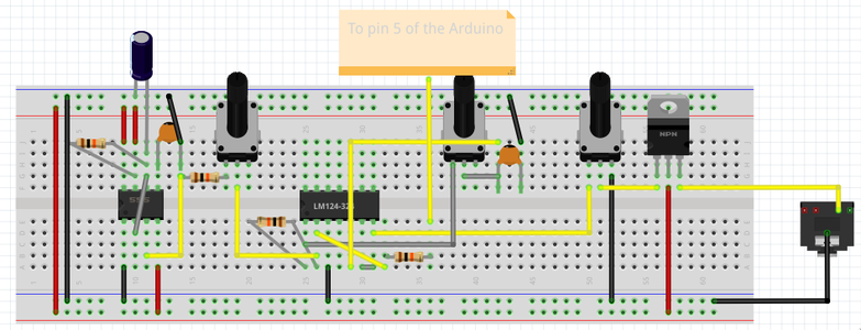

Step 3: Testing on a Breadboard
Before soldering everything up it's a good idea to make sure everything works. The wiring diagram provides all the connections, it should be noted that the connections to the Key Matrix and Arduino aren't shown, aside from pin 5 of the Arduino. Those other connections are shown in Step 2.
Wiring flow
For this project it's easiest to wire from last to first, starting with the output TS jack. My personal TS jack wasn't breadboard friendly so with 2 jumper wires and alligator clips, one from ground and one from the emitter of the transistor to the respective pins on the TS jack I was able to connect it to the rest of the breadboard circuit. The rest of the wiring can just be replicated from the wiring diagram.
