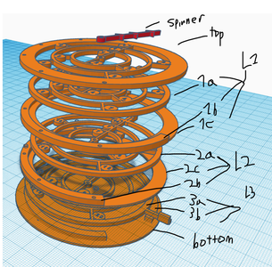

layers in order from top tp bottom
▪ spinner, top, l1(1a,1b,1c) l2(2a,2b,2c), l3(3a,3b) bottom

the dn can be scaled as needed, the original file prints small enough to fit the entire thing in your hand. if you are using a less precise printer (which i ended up having to do) you may want to scale it larger as the numbers may be blurry or parts may not print correctly. this of course will also take longer and use more material, all factors to consider when scaling. scale fasteners accordingly, for this small print I used pieces of paperclip but if you make it larger you may want to use something like toothpicks, nails or narrow screws. ◇ assembly and adjustment.
Step 4: Assembly/ajustments
▪ ideally, everything fits together perfectly as described and you can put your chosen fasteners through the holes and glue or screw it together. but often there are errors in 3d printing, especially on such a small scale so you may have to sand, cut, add bits or poke holes to get everything to fit just so.i had to redo some of the numbers and replace one of the spinner tabs. put the layers together slowly and test as you go before gluing everything together. I ended up using the holes mostly as guides and gluing the layers.
